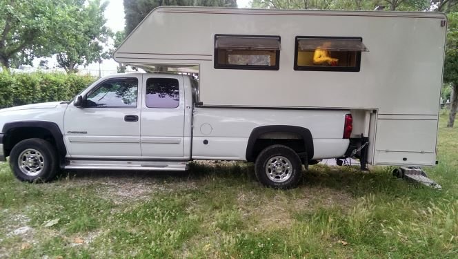

hi . i have a 2003 chevy silverado 2500hd xtd cab long bed 8ft, the gvw is 3500kg with axle weights of 2041 kgs front & 2760kgs rear, also running on lpg, they are available in three bed lenths 5/6 and 8ft , attaching i have eyes on the substantial rear bumper and fabricated brackets on bulkhead,

sorry, should have said that the unladen weight is 20540 kgs full of petrol 36 gallons and lpg 100 ltr.

nigell1 wrote: May 7th, 2020, 5:35 pm IMG_20190614_202217.jpg
Thanks for the info, I wanted to steer clear of anything that big! It may be time to sell and move to a roof tent and LHD car.
