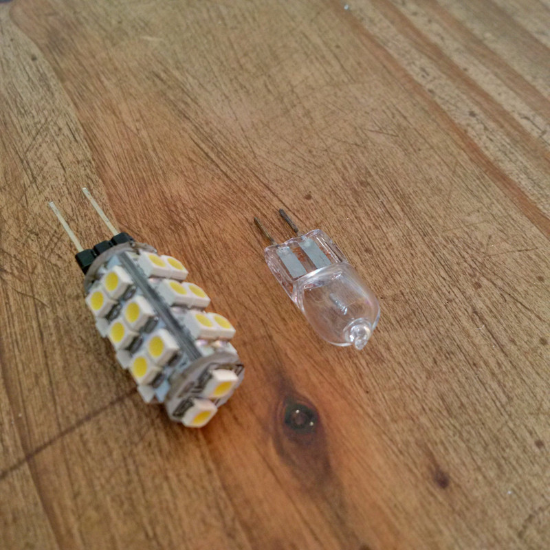

Post: # 27154Post zildjian
October 6th, 2019, 3:37 pm
Was in camper this morning and found examples of the bulbs you would probably want to swap to LED
saving a heap of energy (and the heat the incandescent bulbs creates)
Image Image
new ones readily available on Ebay etc just push in to fit as usual

Figured out those ones were G4 and got some thanks, led seems about 20% of the current for (hopefully) similar light. I am of an age when bulbs only came with a bayonet fitting!
Off to Mull for the rally later this week, will be a good test for them. If they seem fine might be tempted to replace the toilet ones, E14 I think.
