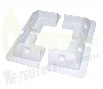

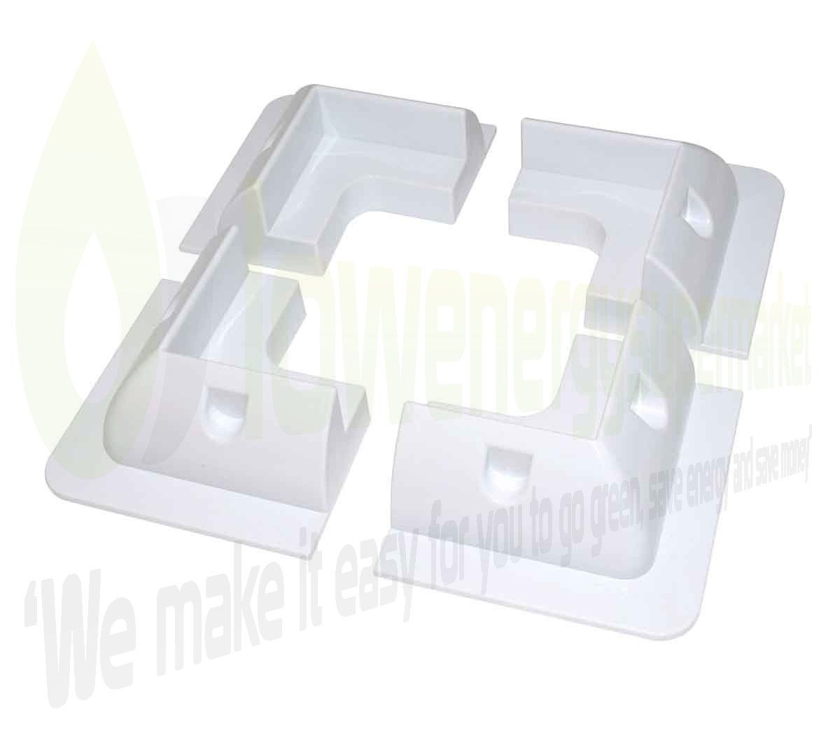

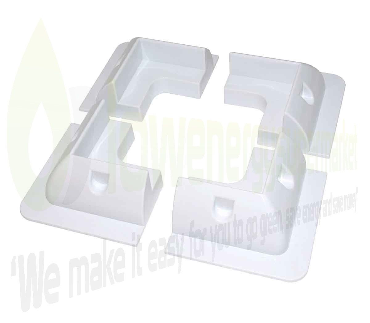

These corners held down with adhesive and panels then screwed to them, plus you get some airflow beneath panel
https://www.ebay.co.uk/itm/Solar-Panel- ... 1gcnZgvOpw

Thank you. Just not keen on putting holes in the roof.
As Steve's Friend suggested, the 'flat on the roof' type are really the next best option and it is better for the panel to be raised with the air flow underneath.
