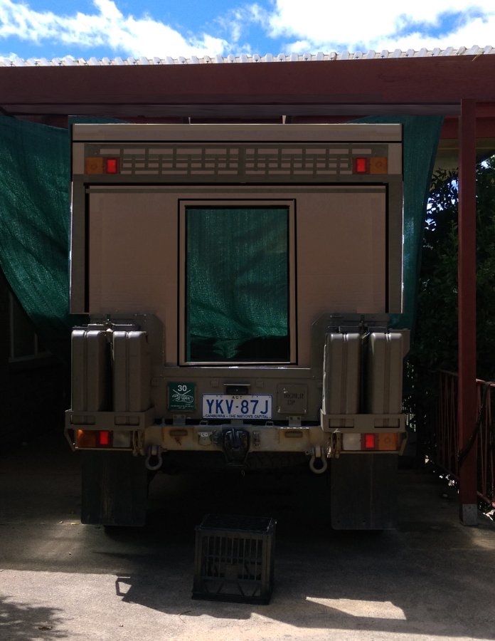

New photoshoppe with a rough of a basket for empty jerries, muddy maxtrax, hi lift or whatever. Sits on the exo skeleton frame.

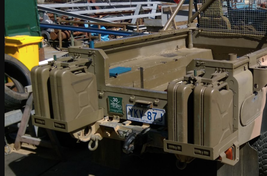

Does this mean jerries are no further back than here still?

Yes, the jerry posn is original to Army. The exo subframe for the camper sits entirely in the tub.
I was in Transport Corps (Reserves) for 5 or 6 years after 9/11 and the simple jerry has advantages over fitting larger in chassis fuel tanks. Grandad was in RASC in ww2 when every engine was petrol.. :?
I think the reasoning was ...
If the vehicle has to be abandoned, the jerry fuel is quickly man-handlable to another vehicle.
If a jerry is holed the only fuel lost/leaked is fuel in that jerry. A large tank risks a lot of fuel if holed and can disable the vehicle/crimp the mission.
If the vehicle becomes bogged, jerrys mean weight can be manually unloaded with other items to aid movement past the obstacle (in my experience seems most often climbing out of a creek) and then re-loaded afterwards.

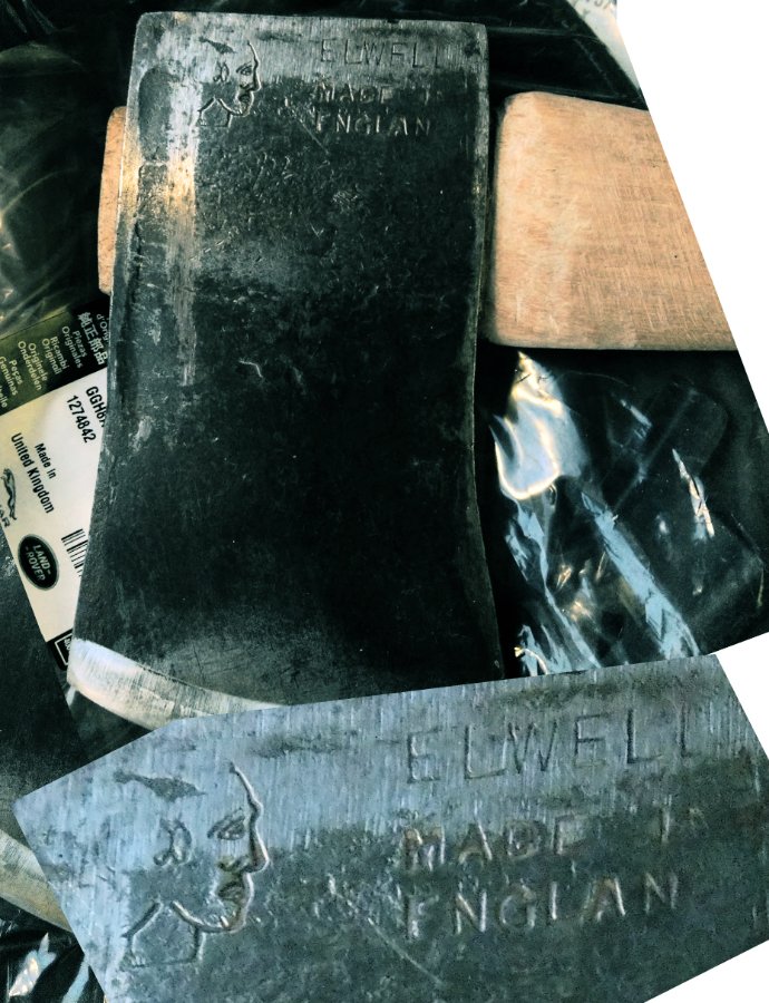

...but you know what its like with a bench piled up with tools and parts and then the old axehead sharpening guy rings back and says 'come get it - its done'.... and then you spend the afternoon on that toy fitting it with a new aussie spotted gum handle that came in the mail last week... and you the get the rasp out and get the handle on... then waste an hour -with no result- searching for the little metal wedge from the old broken handle.. "Right! I told you! "[cue Basil Fawlty rage thrashing the Metro bonnet].
So I took a photo. Can anyone date that axehead? The markings were under 3 layers of ancient enamel, hard and thick like on a 1930s train carriage.

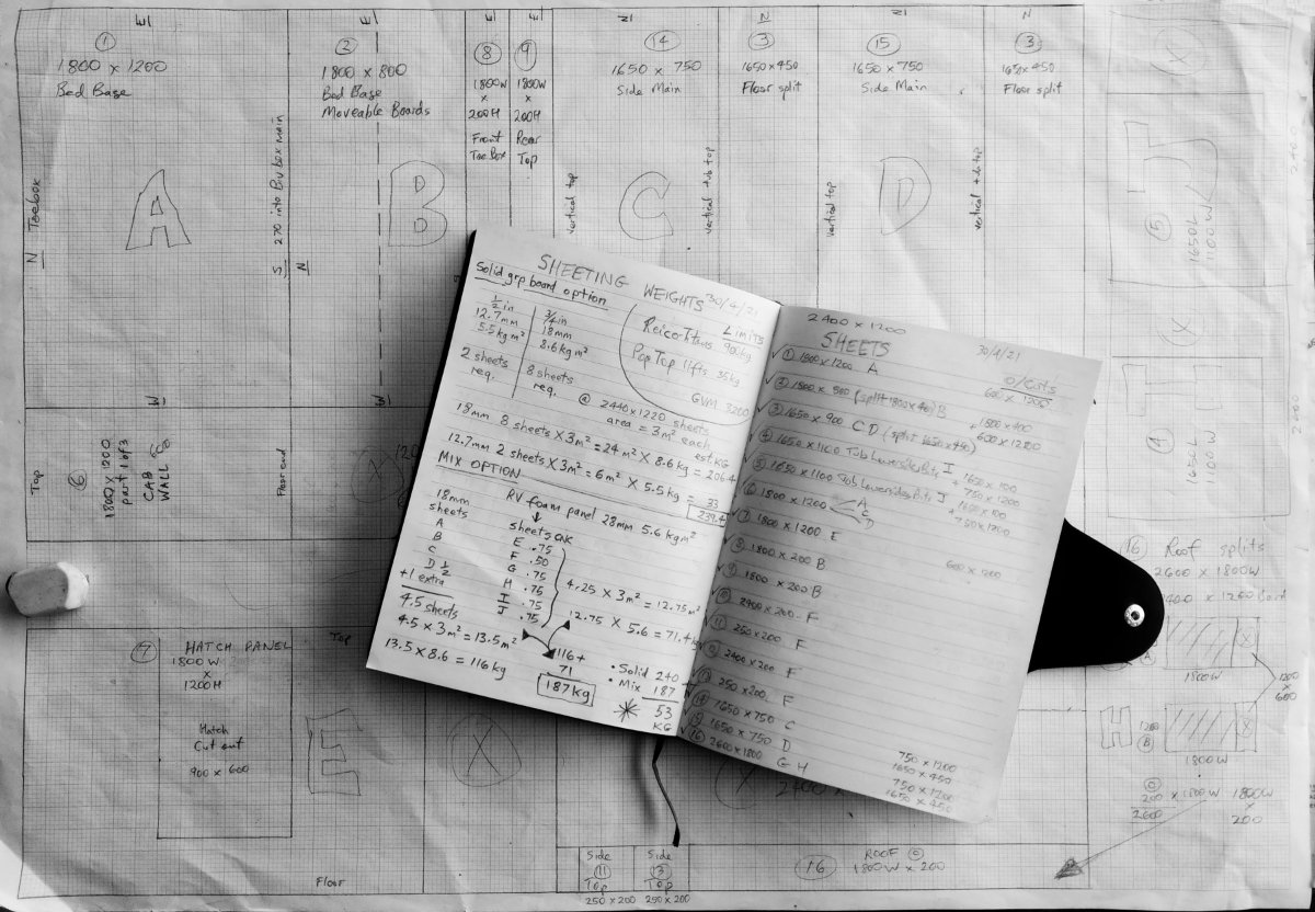

Calculations on the fibreglass poly board for the floor, the lower section of the camper that sits in the Land Rover tub (more or less unseen) - the sheets are 17mm (3/4in) thick, 2440x 1220 (8x4ft). I have to check weight of these ideas for such things as the legs. Well, even if I used those 17mm sheets to do the whole camper they would be ok. The roof could be done in that stuff but in 12.7mm thickness - 12.7mm board is supplied in the same dimension - 3sq metres at 5.5kg a sqm (16.5kg a sheet). The roof is about 2600L by 1800w. So.. say 19kg (under 20kg anyway).

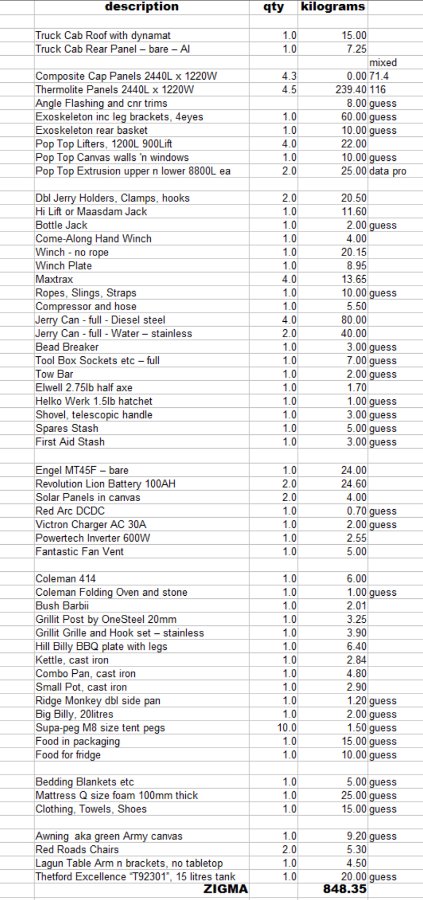

While I was in a weighty frame of mind I made a gear list and weighed items too. The farm jack and cast iron mess gear and stove and lots of items. Some items I guessed. Good to know the options if it comes down to the last 100kg - the target GVM is 3200kg. This LR does have 4 wheel discs and uprated springs from the Defender 130, new bushes, new big shocks, all the running gear is very sound. Its a 30yr old chassis but it was galvanised from the factory hence worth the upkeep and prep.

Elwell axe:
a very old company started in the 1500's with the name disappearing around 1960's when it was taken over.
I would guess your 1930's is not far out.

I looked over spec figures for the various panels and extrusions and updated the weight spreadsheet.
Two panel choices - either we go all solid grp 18mm and 12.7mm board
or we go composite grp skinned styro board on upper panels and mix with solid grp 18mm thermolite panels for the lower sections (tub/floor etc - see http://www.ccaboards.com.au/thermo-ligh ... range.html ).
I am no math guy but I spent hours incl double checking the figures I came up. I began with writing a list of walls and their dimensions and trying to fit them into the 2440 x 1220 boards [3 sq metres] with the least offcut etc, the stuff and CNC program does in under a minute probably. Figures make my head swim.
I ended up going trusty old school graph paper again.
I did the rectangles for sheets and drew the cuts needed for pieces and seeing the off cuts, turned out much better to visualise and calculate. Then I counted the sheets and their respective density figures.
Now my weight zigma is getting in the nitty gritty zone. Do I save ~ 50kg and go with mixed walls or just go with solid walls that can take waterblasting to get rid of mud and insect splatter... and have a box where pinstripes from tree scrapes do not concern. Also less combustible.
