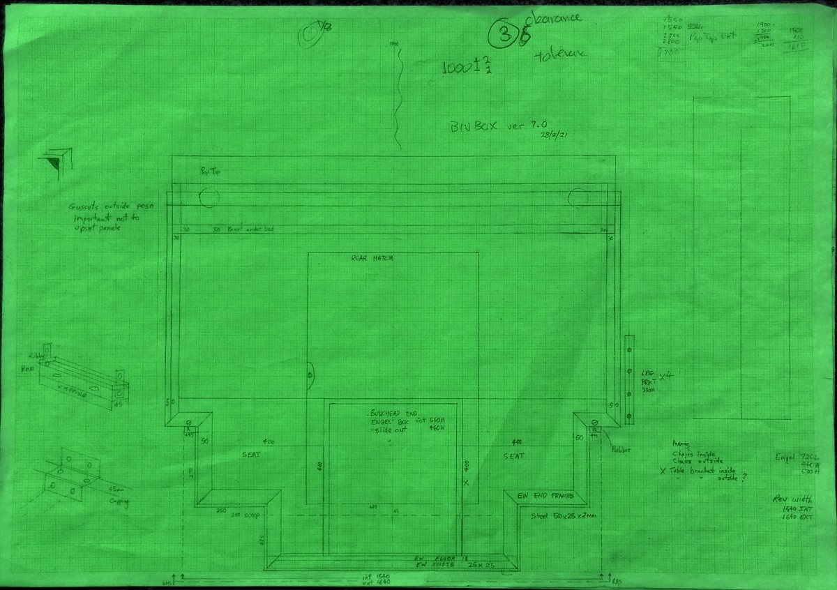

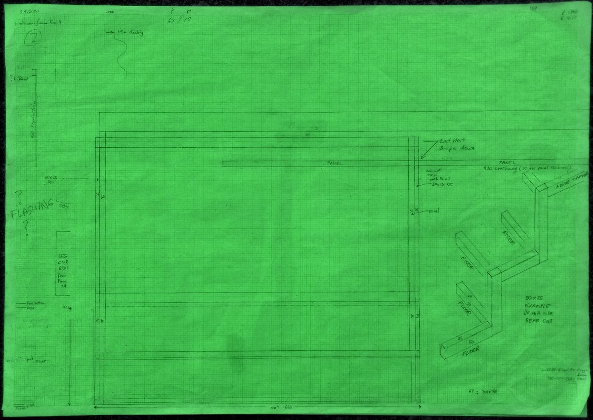

:idea: Back in Sept 2020 I finally began drawing a demountable camper for my 110 Land Rover. I am not a drawer, or skilled in welding but I thought it would be better to waste time and effort on paper rather than on materials and tradies charging $150 per hour.
I took graph paper and a pencil/ruler/rubber to work and did some drawings of a trailer camper in the quiet periods. A must've done 6 or 7 drawings from the start of the chyna virus but by September I had second thoughts and decided to go with a demountable and ditch the trailer.

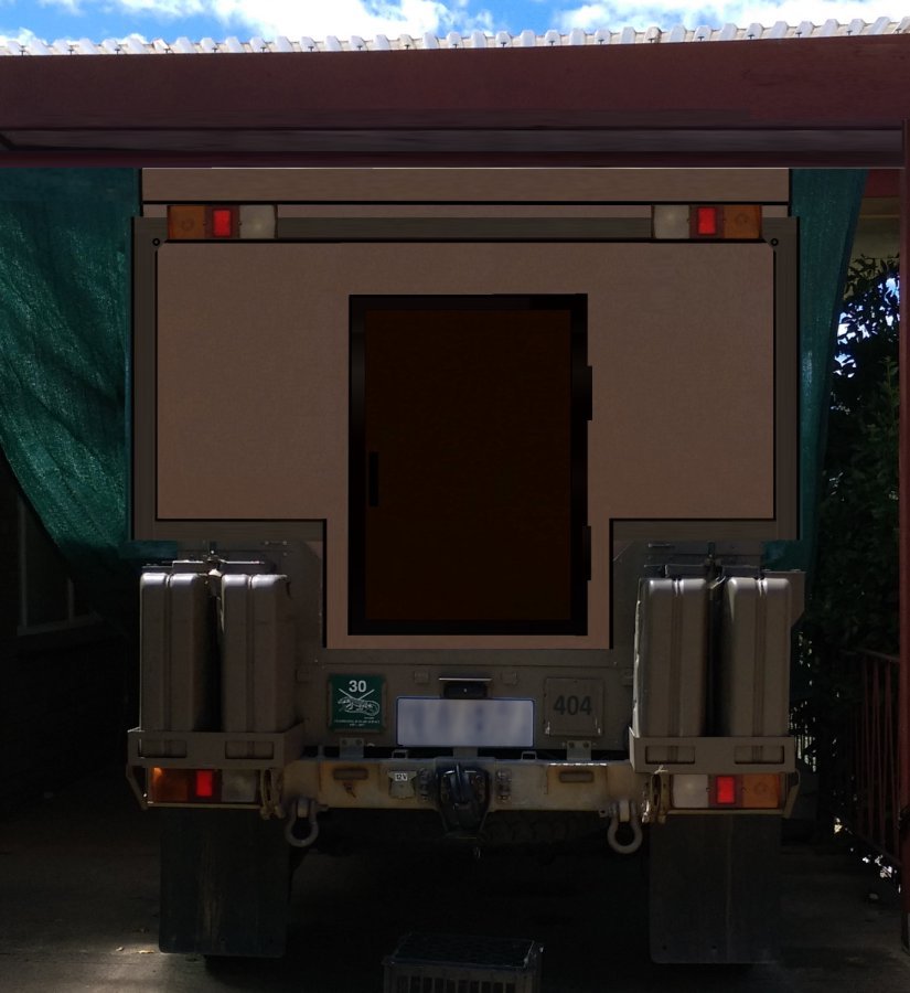

Lately I have showed the drawings to a welder and used cardboard to trial the rear hatchway (yes we both got in and out okay).
I took a photo and manipulated it in photoshop. Photos/cameras are more 'up my street'.

Teardrop rear hatchway arrived today. RH hinged. 900mm high 622mm wide. We tested the fitting before ordering using a cardboard 'back end' trying out ingress and outgress. Result - all good but a grab rail would be nice.

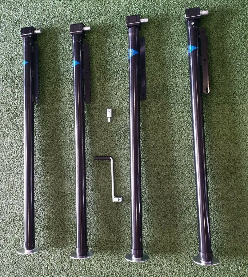

Rieco-Titan legs are here already. They are HD and made in the USA. I avoid chinesium products like the plague. They are needed to lift the bivbox up high enough to clear the Land Rover tub which is high due to ground clearance. It clears by about 120mm. I tested the lift with a cardboard trial. I like cardboard trials.

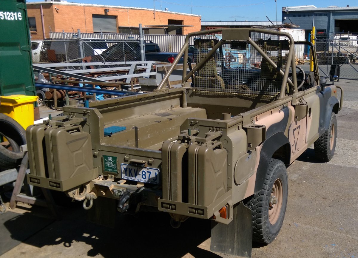

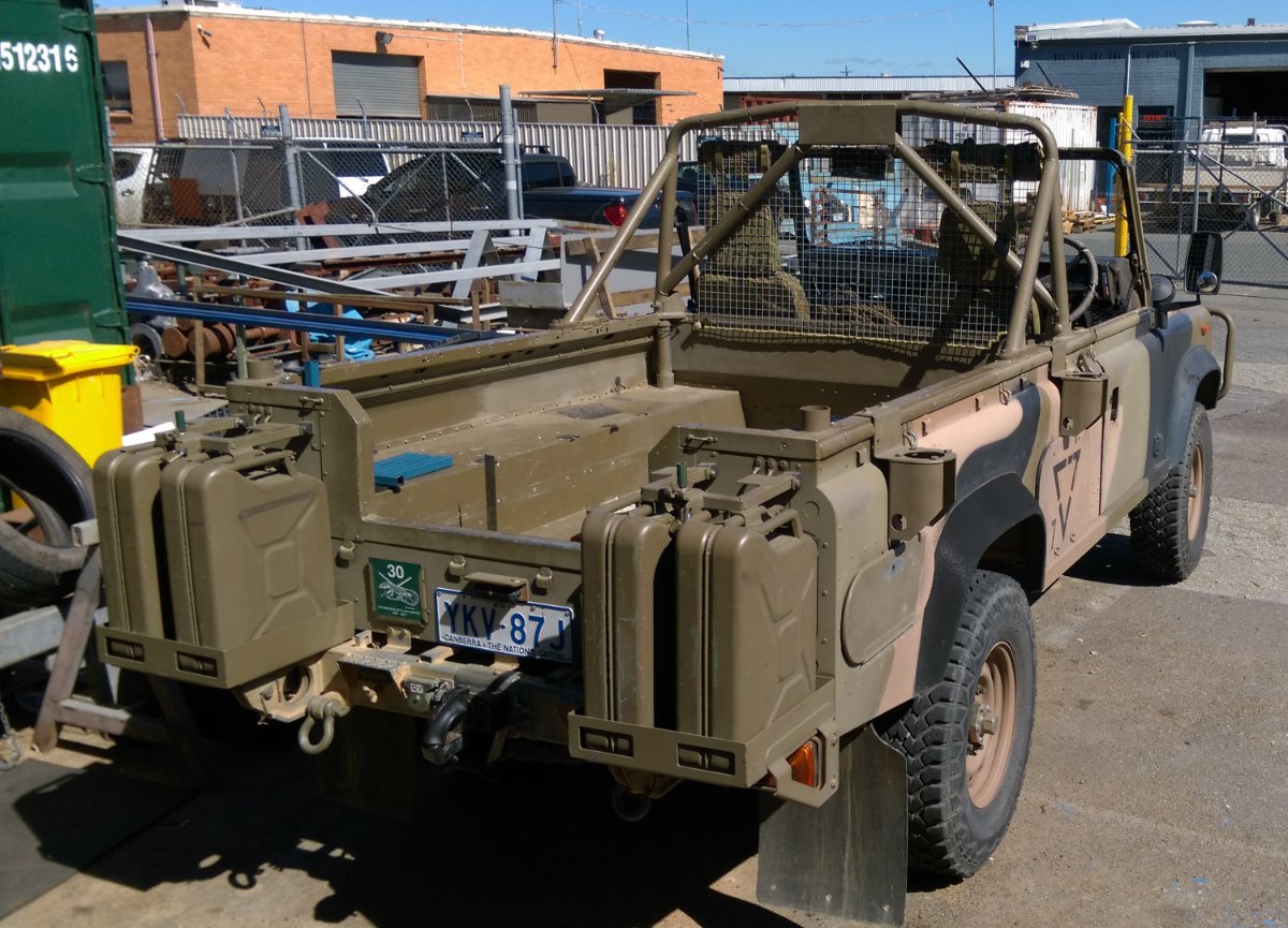

Our Landy is a 1990 ex-military FFR and does not have a tailgate as such, it has a cut down rear panel (a "troop scoop"). The exact opposite to a modern tub such as is on the Defender 130. We have enjoyed pedalling older military Land Rovers and maintaining them.
We have owned our modern one (3.9 Isuzu diesel engine and synchromesh!) since 2015. We have upgraded it with dual rear springs and rear disc brakes, turbo, braided lines, modern front turrets, new adjustable Tough Dog shocks, new radiator and hoses, new slippery diff at the back, new CVs (and hubs), new hardened axles and flanges, and other things (I have a long list).

attached drawings to date and a rear photoshop rough.

Biggified your drawings, :)
You live in a country renowned for its slide-in campers so you'll not be stuck for tried & tested construction

I just edited the text (the rear hatchway just arrived :) ) and added a pic of the Landy.

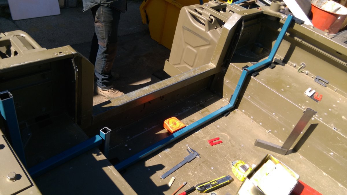

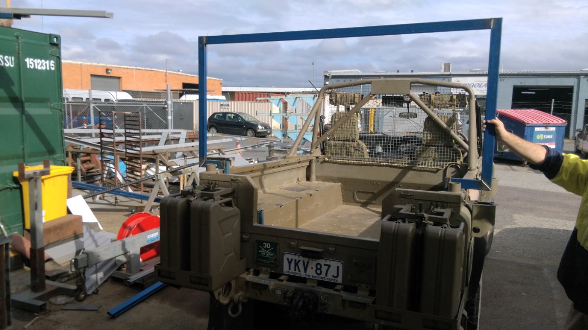

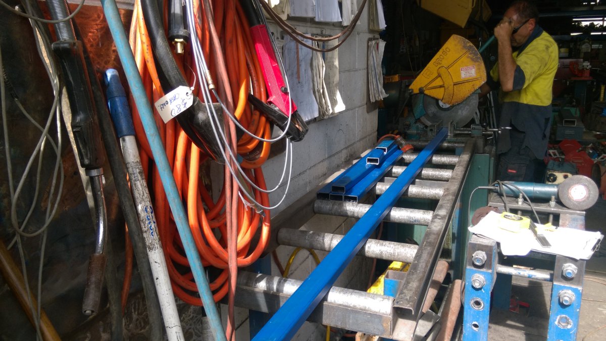

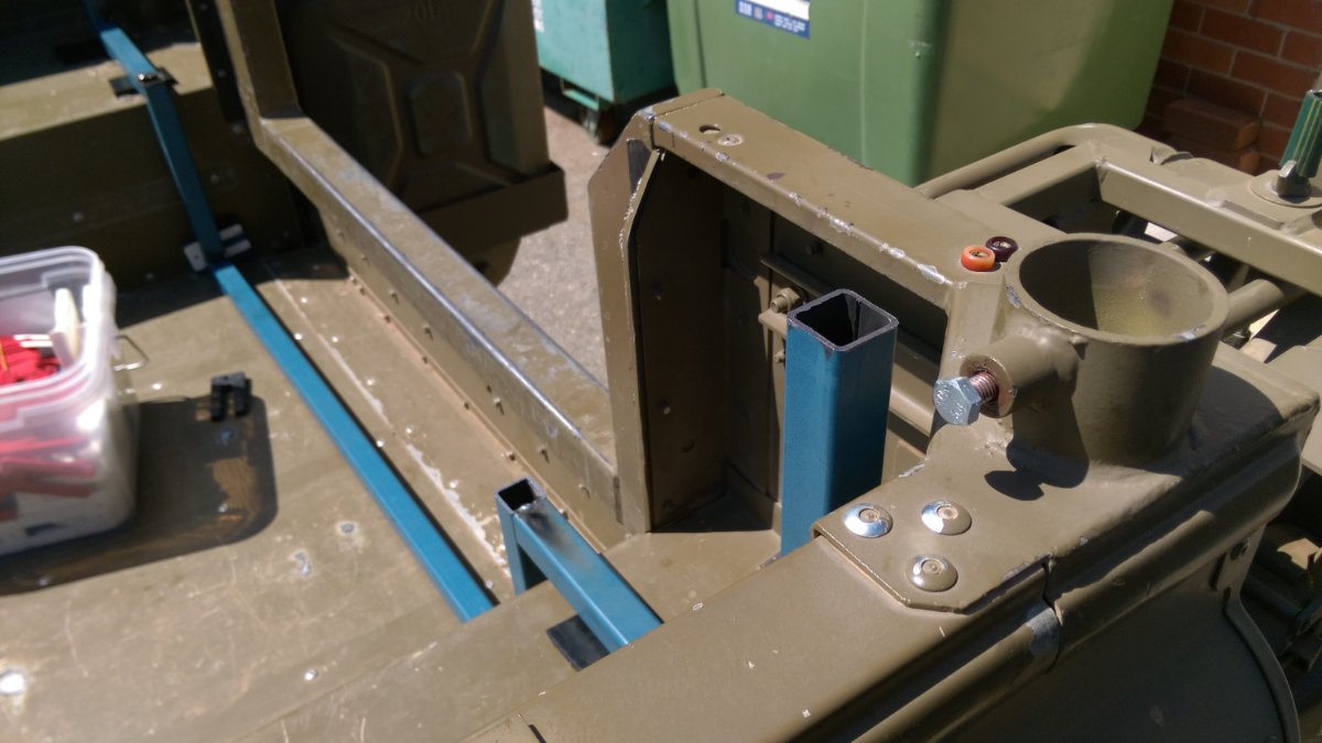

This beautiful Friday morning I drove the Landy 'sportscar' about 12km to the welder's yard to begin the frame work. It was a short time after sun up and really pleasant.

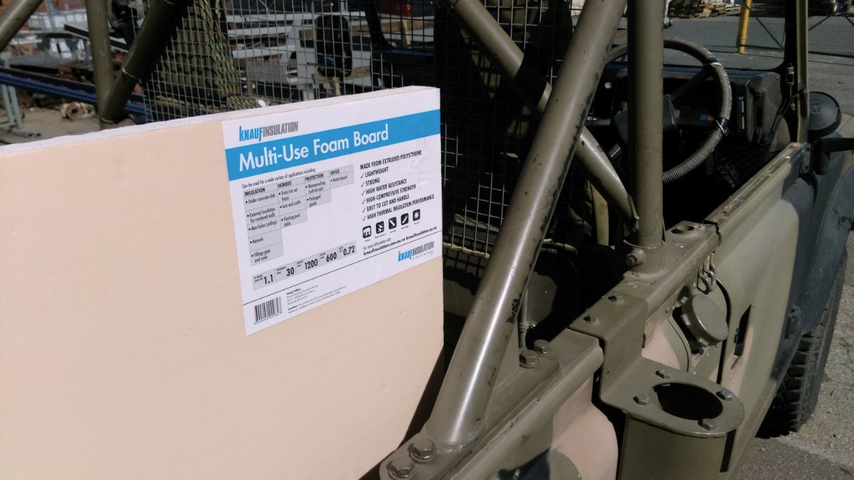

Today was a short session getting things underway, e.g.; the 9mm thick insertion rubber strip and orientation. I had a piece of foam board to do simulation but we didn't get that far along this week.
Framework - some floor pieces were cut to be tack welded. When the east-west subframe piece is checked and 'right' there will be 5 copies done. Afterwards I drove home in proper traffic :(
Next Friday some more welding. The main thing is the biv box is underway. :)

More framework yesterday. Totals 6.5hrs on the jobcard so far.
A few rethinks took time as you do on one-offs. Some mods on the 25x25 bits then tacked/checked the first east-west floor piece for fit, checked the insertion rubber and gaps. Now that we're okay on them there will be 4 more cloned off the first.
SIzed up and began cuts of the first 50x25 corner pieces. Again, a hands on practical mod was made to width - to better accommodate the 4 leg brackets and make sure the legs clear the vehicle sides.

Front and rear frames are done.
