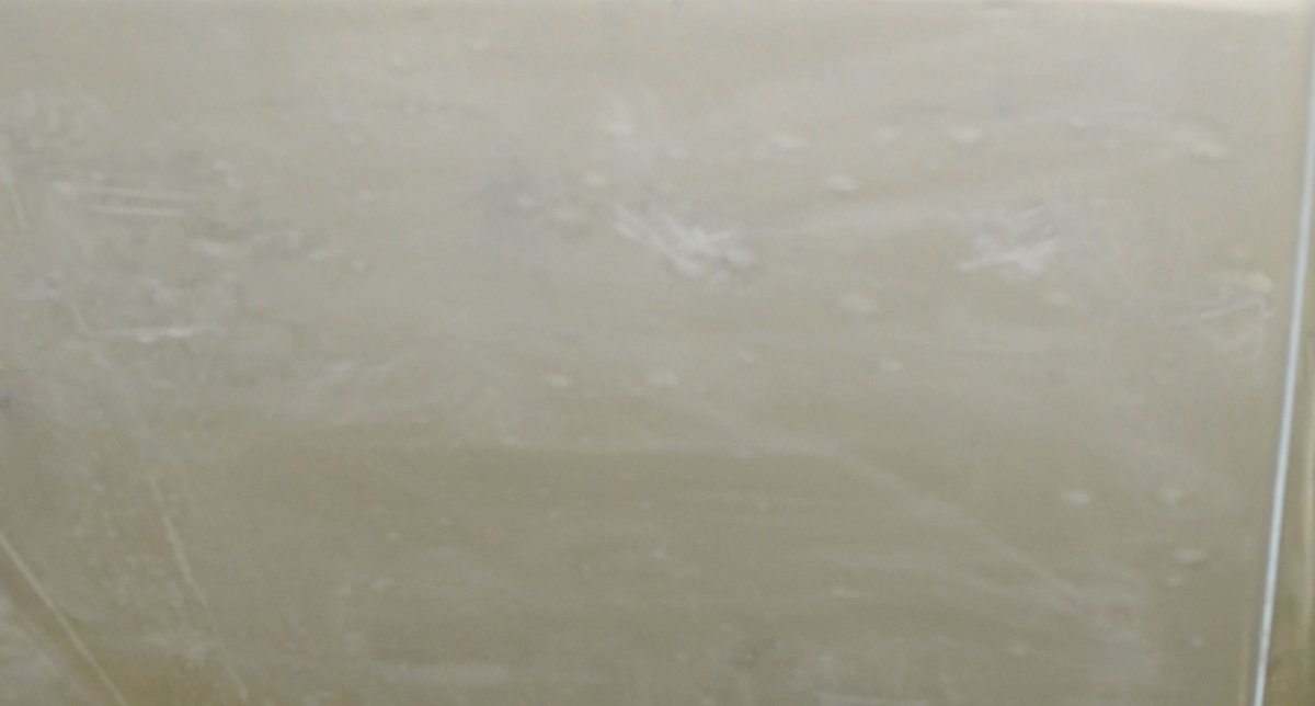

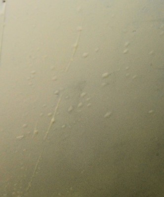

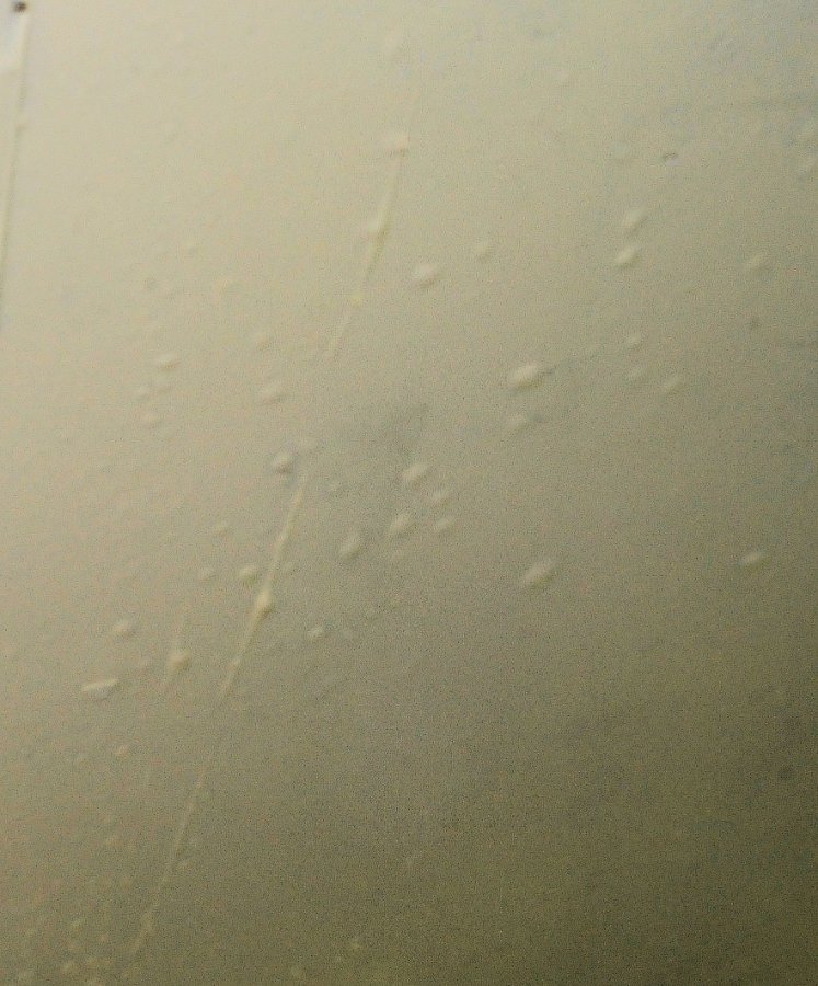

OK I went under and took some photos of the blistering, unfortunately white on white did not work well.
Best described as a rash of small blisters.
and after sanding still not very clear - I need a cloudier day - back to the field tomorrow and maybe some better photos
