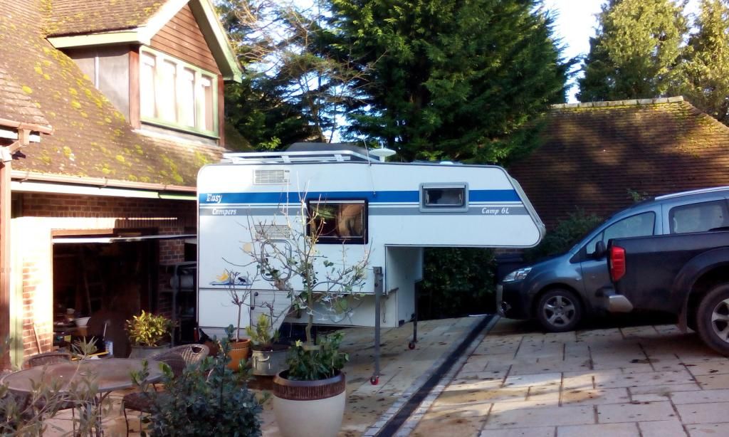

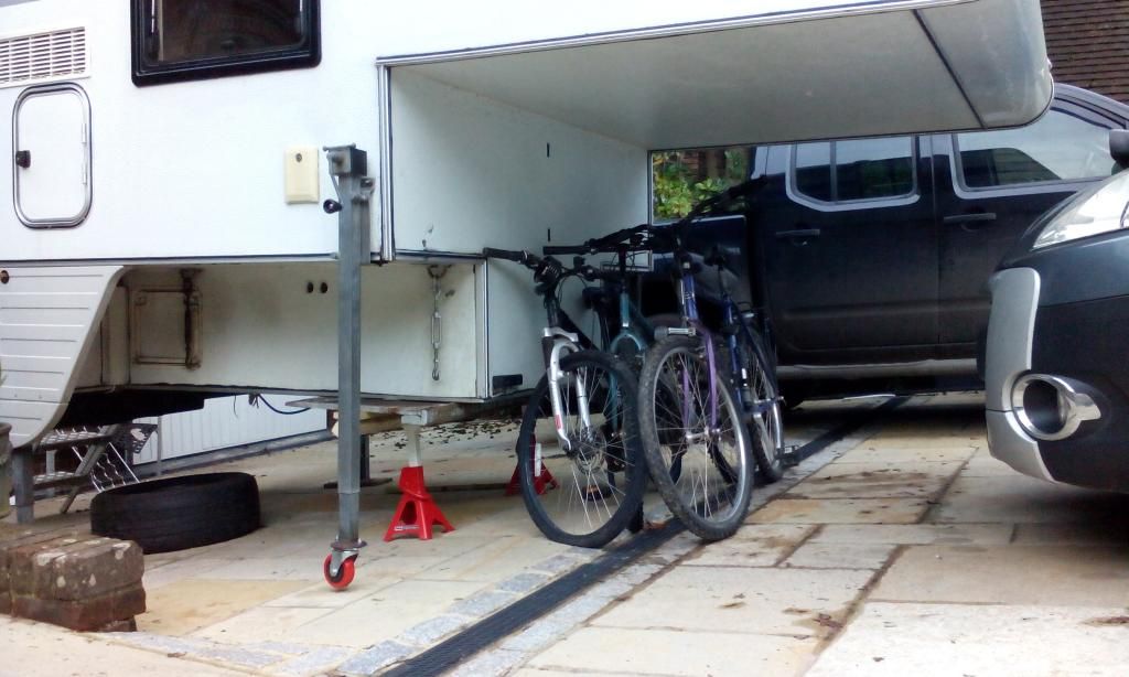

Post: # 3168Post Sheriff
January 11th, 2015, 5:21 pm
Feet off the ground and a new bike shed.

Post: # 3175Post zildjian
January 11th, 2015, 6:21 pm
I think it was Sue Morris had a neat 'curtain' looking awning enclosed that area when camping on their NSR

Re: Hill parking problem solved
Post: # 3193Post Mike
January 11th, 2015, 9:09 pm
Looks good, we have the curtain under the bed area, it came with the Nomad. The guy we bought from makes them, see nomadcamper.co.uk. he can make them up.
