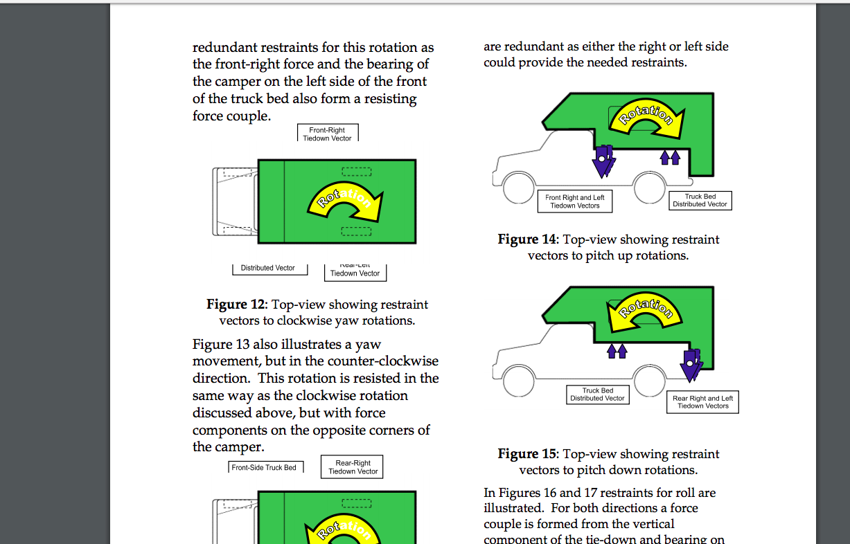

If you think you're over-thinking it, you should check out this guy! :shock: http://truck-campers.uk/docs/maglebyreport.pdf
Bli-mee!
but for his work on airframes (mentioned) I'd have thought that was a thesis by some nerdy graduate as part of their degree
