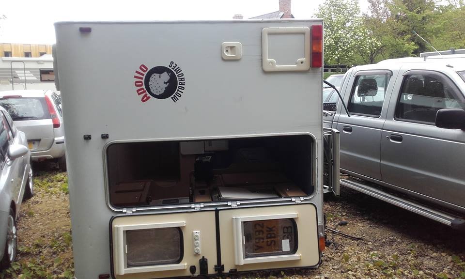

Example of rot in leg support area causing member's camper to just collapse on that corner and topple

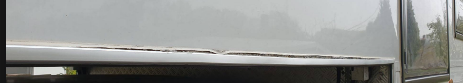

Also prone to water ingress in overcab/Bed area behind metal trim
