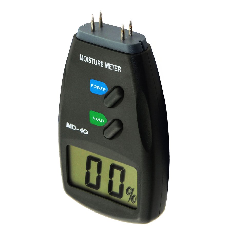

When buying any used camper we always recommend taking along a damp meter these are cheaply available from Ebay £8.79
and simple to use and can save you a lot of money and act as a bargaining tool.

there have been mention of roof issues in past with earlier model which had to go back to dealership for extensive repairs/replacement so again look carefully for evidence of water ingress using eyes,nose & damp meter!
