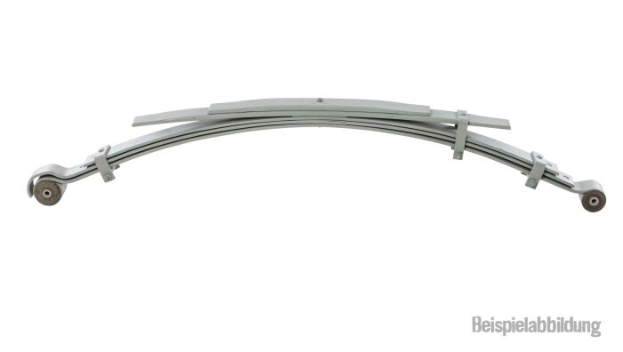

Because of the aditional weight, and the fact that my Amarok add originally the Comfort Suspension (2+1 leaf springs) with the Aldo wheels, i have upgraded the suspension to Heavy Duty (3+2)
I have also added the VB Semi-air to the rear axle.

About the leafsprings, and the heavyduty on a Amarok, you really need them with over 650kgs + the more than 270cms Height of the pickup Campers. And this is because when selling the Pick-up trucks (At least in Portugal) most people search for confort (the ones who spend more in each vehicle), the others who search for heavy-duty springs leafs (3+2) are the ones who either have a singlecab, ou a double-cab but with only 3 available road seats (per tax purposes they are cheaper).
