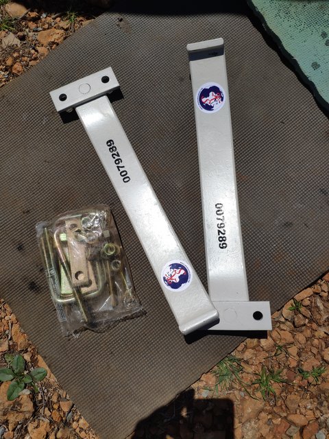

You may not get any instructions but this is what you DO get in the box - 2 hefty helper springs and a bag of bits.

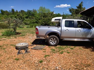

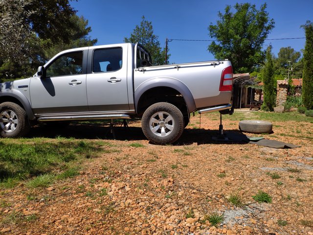

First step is to get the back end of the pickup chassis jacked up. This needs a high lift jack because it's necessary to lift the chassis but to leave the axle hanging on the suspension. There was no indication one way or the other in the instructions but I decided not to bother removing the wheels. It just seemed like unnecessary hassle and there's plenty of room to work under the back end once the spare is removed and the chassis is jacked up - and supported on axle stands of course.

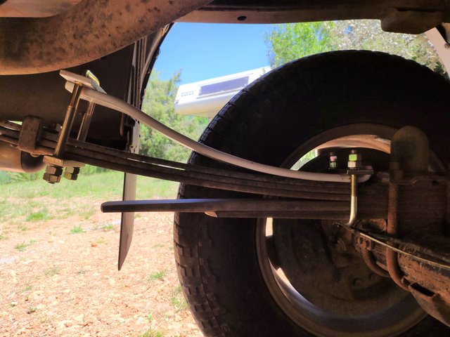

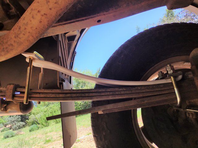

The helper spring goes behind the rear axle with its front end butted up either against the bump stop, where the axle is below the rear springs, or against the axle housing if the axle is above the rear springs. The helper's front end is clamped down onto the leaf spring with one of the smaller u-bolts and crossplates from the fitting kit and secured in place with washers, nuts and locknuts.
So far so simple, but here's A TIP to save you having to fix it and then unfix it as I had to do: the rear u-bolt can be installed either way up, i.e. with the threads pointing upwards through the crossplate that's fixed to the top of the Load Plus, or with the threads pointing down and fixed through the inverter plate below the leaf spring. The choice may be determined by necessity, in order to avoid potential conflict between the Load Plus fittings and brake lines for example, or it may simply be a matter of preference. In my case it was preference, for reasons which I'll explain later, but I soon discovered that, once the front end of the Load Plus is clamped down with the small u-bolt, there isn't room between the rear end of it and the chassis to be able to put the larger u-bolt into position from above. Doh! :oops: It should have been pretty obvious really. Fortunately it was very simple just to loosen off the front end, put the rear u-bolt through the helper's crossplate at the rear end (as in the last pic), and then clamp up the front end again.

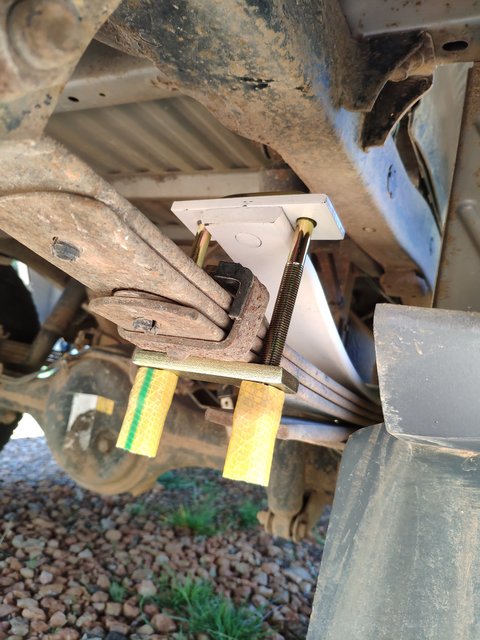

Fixing the rear u-bolt with the inverter plate below the leaf spring leaves very little exposed thread, certainly too little for the nuts to catch once the spring washers are in place, so I found it necessary to compress the Load Plus slightly. I used a G-clamp, which was very simple, but a bit of wood wedged between the chassis and the helper spring would be just as good and you can always get it out again once the u-bolt's been tightened up a bit.
The whole idea of these helper springs is that they are adjustable. I want to be able to crank them up when I put the camper on but I don't want the pickup suspension to be any harder in normal use. For that reason I tightened the nuts on the rear u-bolt just far enough to get the lock nuts on securely. In that position, with the jack and the axle stands removed, the back end of the unloaded pickup sits at just about the same height as before and the ride is unchanged ...
... but before putting the camper on I'll wind those nuts up an extra 40mm, or so, as per the instructions.
It's because I want to be able to adjust the Load Plus springs with as little hassle as possible that I fitted the rear u-bolts with their threads downwards. In this position the nuts and locknuts are very easily accessible under the pickup bed just behind the rear wheels. Finally, I've pushed a short section of hose over the nuts to keep out the worst of road dirt and ensure that they remain easy to adjust.

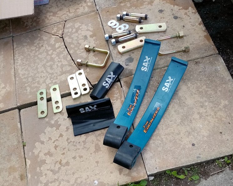

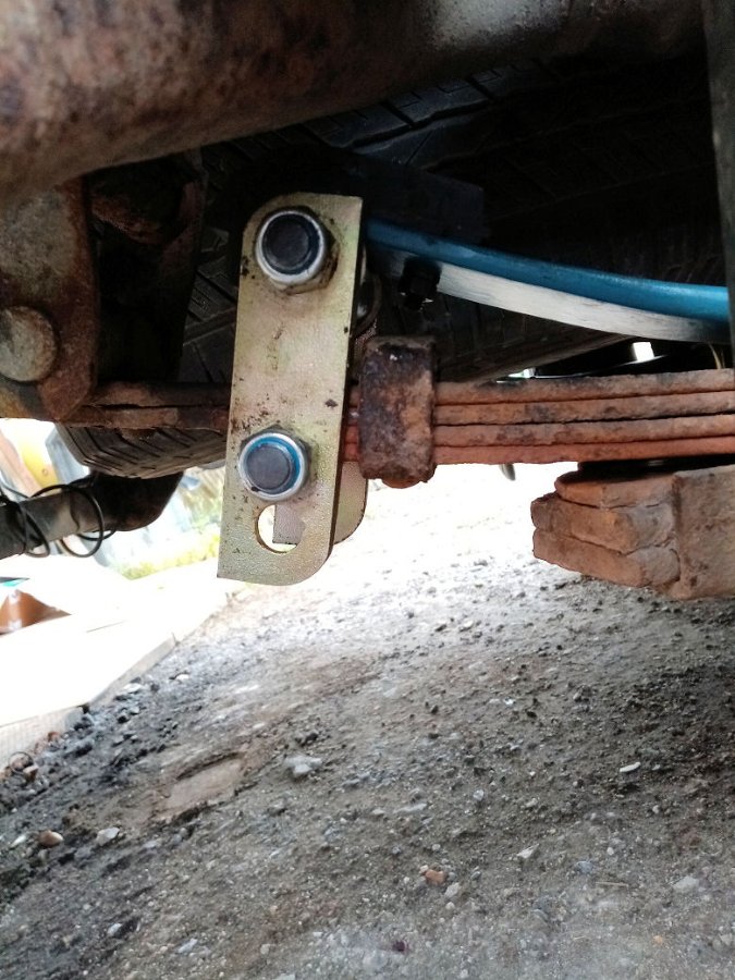

My load helpers - SAX Equaliser, are like saDgit describes fitting to his truck with differences. So start by jacking up the truck.
As you can see there are a pair of conventional U Bolts, with a flat plate, these clamp the spring assister at the end nearest to the axle. Initially I did not fully fully tighten the U Bolt.
At the other end is an eye (much like a conventional spring eye). A bolt goes through this eye holding 2 flat plates. Grease the bolt before inserting it - it makes life easier - each bolt also has a grease nipple (I LOVE NIPPLES ;) ) to my mind a sign of well thought out design.
Each plate has 2 lower holes, decisions! decisions! hard ride or softer ride. Soft Ride lower hole, hard ride upper hole. I opted for the hard ride as the demountable lives on the truck! As saDgit described this involved using a G-Clamp (if I had used the lower hole - softer ride I would not have needed the clamp)
The bottom bolt has a hardened steel roller round it so it moves with the spring.
I then tightened the U bolts hard down.
Finish off by dropping the truck back onto its wheels - retighten the fastenings (not too tight as the plate must be free to move). Take for a test run involving a few roundabouts and back for a final tighten.
I can now report the back end is distinctly up instead of looking a bit droopy - tomorrow I have to go under with her on the ground or on ramps to check the length of the brake compensator spring - it may be "kidding" the compensator that the truck is unloaded!
