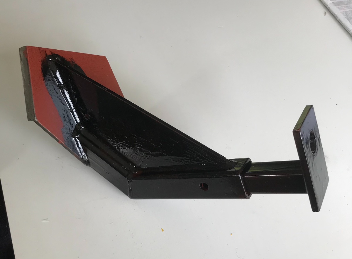

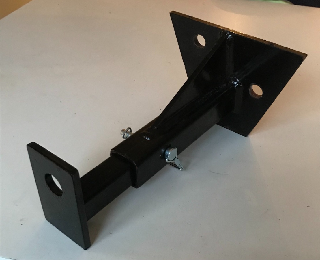

Further to my questions last year about getting my Northstar 700 secured onto my Hilux I went and had some brackets fabricated having made cardboard models for a custom fit, rear ones easily bolted on and front ones to be welded on this week! Pics of result at the weekend.They cost me £180.00.
Re: Northstar 700 on Hilux double cab
Post: # 30173Post derestrictor
March 14th, 2021, 4:52 pm
they should be just the job, bet if you had ordered those from Torklift in america they would have been as much in tax duty

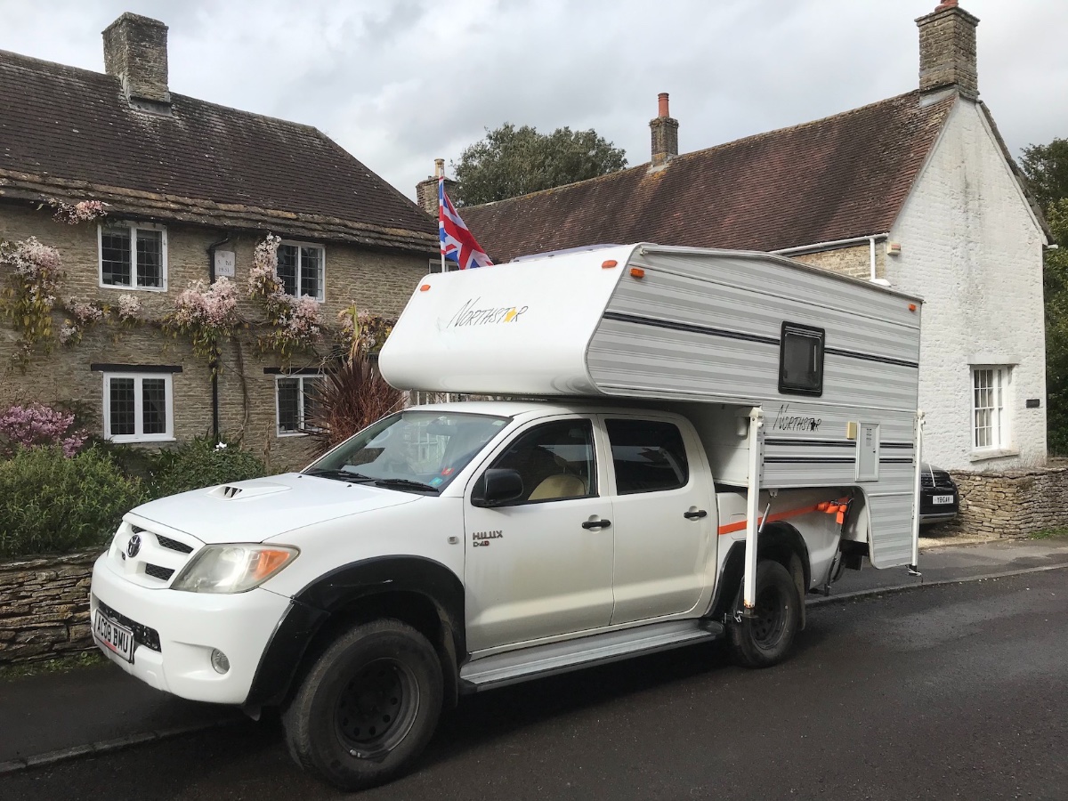

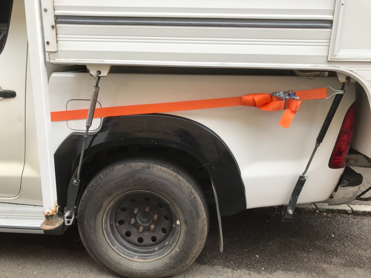

Finally ready for the off !
Posts: 26764
Post: # 30314Post zildjian
April 6th, 2021, 7:35 pm
That's it!
they look just the job & both pulling <forward just a little too so the orange strap should be belt & braces
but can't do any harm,
Where do you plan going first :)
