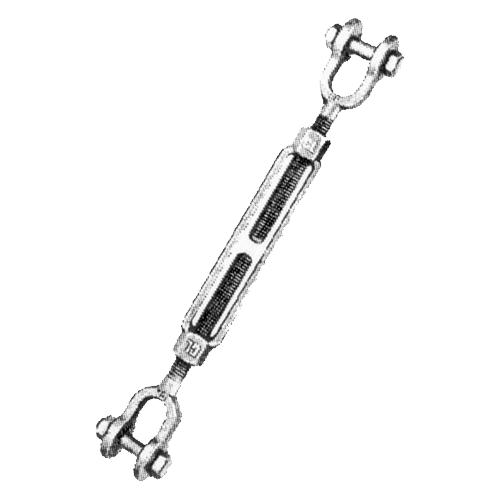

To attach camper>vehicle you can use a turnbuckle (Ebay/Amazon/Chandler) again available in different grades and lengths to suit
or your camper may come with them already.
