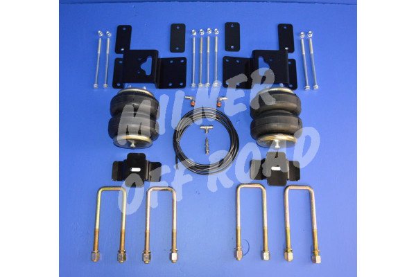

I was looking to fit a rear air suspension kit on my L200 & have found a very reasonably priced kit from Milner Off Road for £263 inc vat which seems a lot cheaper than anyone else. The kit is here:
https://www.milneroffroad.com/mitsubish ... 8k/SU0108K
Any thoughts?

Nothing peculiar or different in chassis rail on yours compared to crewcab is there? if it looks the same in that area I'd risk it
maybe a call to Milner see if they've seen one fitted to clubcab

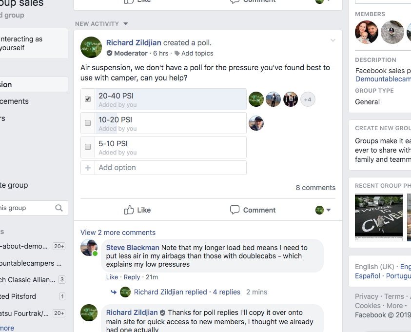

Have bought & fitted the above kit but there is no guidance as to what pressures to inflate the air bags to, any advice?
Posts: 25579
Re: L200 Air suspension kt
Post: # 26927Post zildjian
September 6th, 2019, 11:57 am
Truck without camper; 1-2 PSI (to prevent damage to air bags)
with camper, as low as you can to improve the ride
typically mine for example are maybe 35PSI
think we had a survey somewhere I'll see if I can find it

Thanks, what would be the safe maximum? The instructions say to inflate to 50 psi to test for leaks.
Posts: 25579
Post: # 26932Post zildjian
September 6th, 2019, 6:53 pm
Well essentially you don't want to be above 50 (or really above 40 I'd say)
air bags soften the ride a lot ✔
correct headlamp angle ✔
but exert a lot of pressure on small area of chassis rail where that pressure wouldn't normally be ✖
so always go with minimum you can live with
