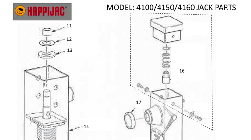

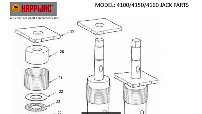

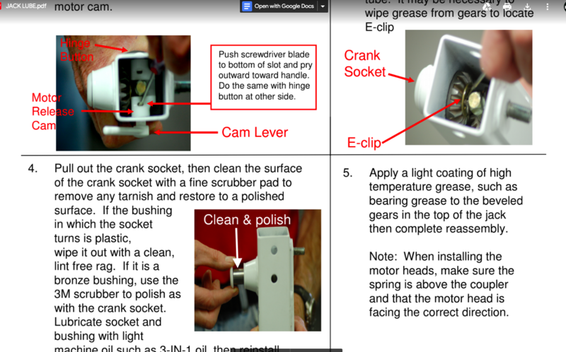

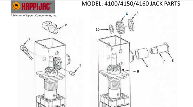

Hi All
I looking for some info on Happijac Legs i want to dismantle one as it is sticking a bit. I thought i had seen a video or instructions on how to dismantle the legs somewhere but cant find anything can anyone help Plz..
Cheers
Paul (Buteman)

viewtopic.php?f=9&t=1386&p=21607&hilit=happijac#p21607
This thread might be of some help, at least shows what to expect on strip down

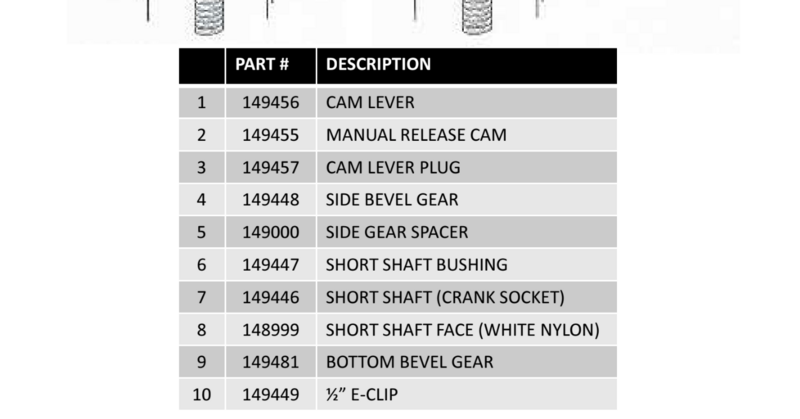

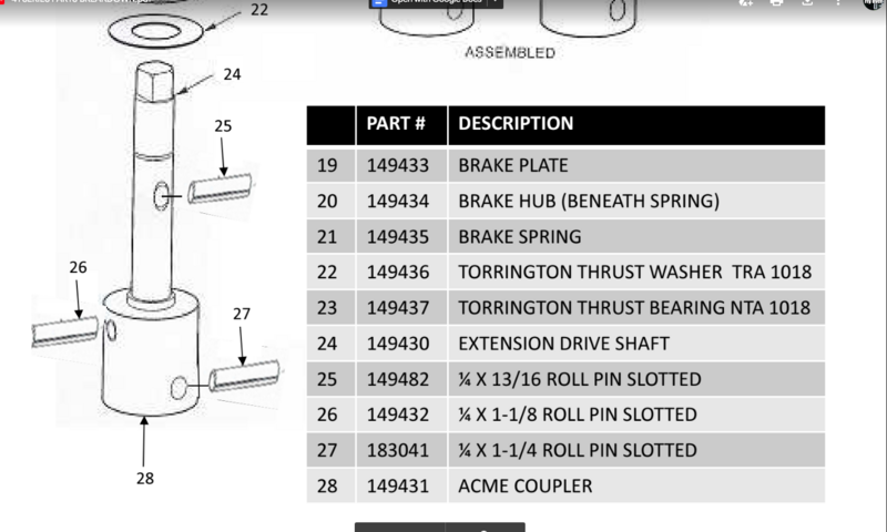

Post: # 26680Post zildjian
August 11th, 2019, 8:36 pm
our Mike has exploded drawings for Happiijac's and he's emailing me them, depending how many and how involved they are I'll forward them to you or post them up :)
