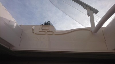

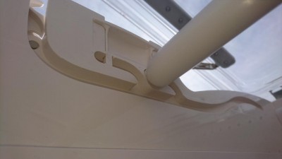

With whatever sealant applied to underside of Skylight you choose to use (they recommend Silkaflex)
I used a double sided tape to bed it down to roof with, followed by bead of Silka round outside,
In these pics you can see how their fixings locate in underside with prongs (to keep it aligned)
then up to three screws holding it to both upper half and ceiling
they say to you have up to 20minutes between plonking it on roof and pulling it down inside by its fixings
