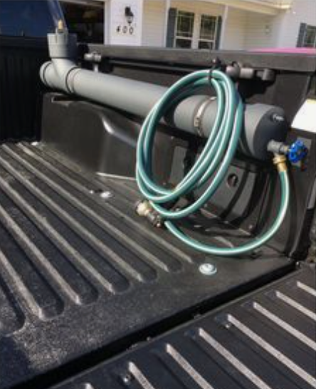

avoiding floods is a combination of securing fridge/cabinets/drawers shut and if you can locate tanks out of harms way in tub,
so much the better definitely, seen grey tanks in pipe form done like that, don't suppose its so much different for fresh water.

The greywater pipe option is a good idea. I just happen to have about 8 feet of 6-inch pipe that would be suitable.
I'll put that on the list :lol:

Can't find the exact one i saw but it was along these lines.
Might be better if fixed to camper (if room alongside) for safety
