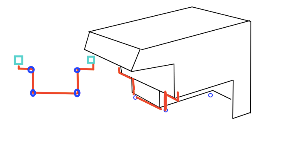

Front fixing;
Contrive two ratchet strap buckles to fit on front leg fixing points (pictures to follow)
pass cargo strap from one side to other via eye on underside of camper and through eye's in front corners of load bed
turnbuckles proved too fiddly for me too and always always came loose regardless road surface, with mine I can pull up the tension at any time from beside camper
