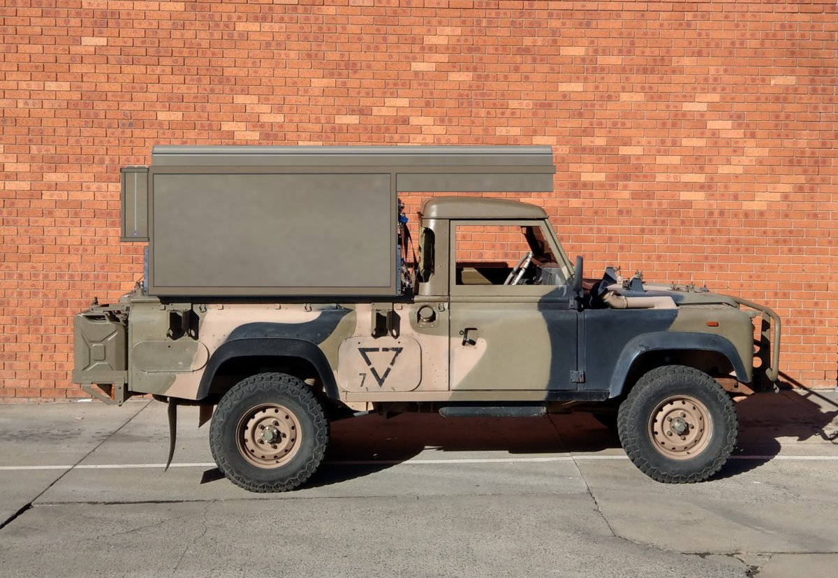

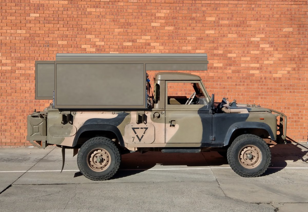

All ready for the weighbridge and an insurance quote on Monday. What a hectic Friday...
:D kidding, just photoshopping the Luton aka master bedroom. Friday was postponed. Now Monday afternoon is booked for welding the Luton bars. I considered the bar lower down to support the lower corner joints but it looked 'orrible.
As for the frankenflanges, maybe Monday as well.

Just a personal opinion.
You said you are limited to cab-over extension by the hood hinges. Looking at your mockup I would consider if it were possible to alter those hinges to allow more extension. The further away from vertical you can get means the hood front edge is getting lower with the arc.
It's just it looks very short (single bed?). If I were to contemplate a second build would make the overall dimensions smaller but I would increase the over cab bed width as 4 foot seems narrow when you're in it.
Looking good though 8-)

Land Rover owners in europe and elsewhere have noted the huge rise in vehicle theft and the market has responded with a variety of knick knacks. One thing was better hood aka bonnet hinges. I fitted front of hood locks but the hinges at the firewall screw on. To remove the bonnet i could unscrew them like the thieves.. Maybe a change of hinge would kill two birds with one stone therefore allowing a longer overhang.
The original idea was to copy the market where the bed base is two thirds into the main living area, made with 2 full width boards and a mattress in pieces that stash away during the day (out of the way) up front in the overhang. This means both people have to get out of bed to make a morning coffee, unless it is warm enough to go outside to make coffee.
Morning coffee in bed can be a real luxury for the "other half" and improve the overall comforts of home and increase the level of general feelgood. So does hotwater shower... we have roughed it in swags at times and, short term, no probs. But longer term, a year going around Australia, I think little lightweight luxuries are important for 'sustainability'.
This switch out from a hard shell Maggiolina roof top was because 3 or 4am leg cramps (nerve pinch) or foot arch cramps (i get them bad) meant there was nowhere to stand up and stretch to relieve the cramp so you had to clamber down a cold ladder in your undies to take a few steps on the ground. Bad news. I just wanted a Luton aka overhang camping overall design do-over to be able to stand up beside the bed for cramps and -bonus- be able to get dressed/undressed inside like a full height tent. The rest of the bonus features like extra security and bad weather space sweetened the whole deal.

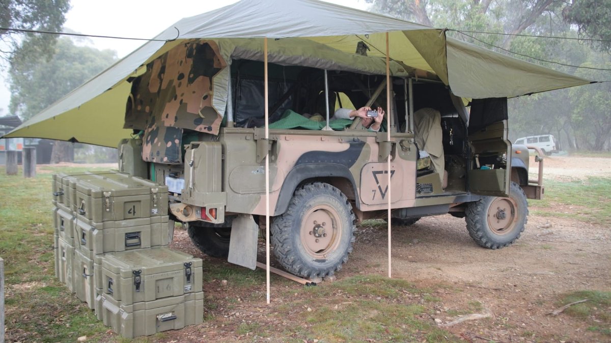

The pics are from about 2016 when we used to put everything in the containers. I think we have culled items and could get away with just 4 now. The big lego design means you can make them into benches outside too. When a cooking oil container broke on Broken Cart Track the mess was limited to one army container. In a regular campervan the oil would have seeped into every bit of cupboard framework etc. Good reason to stick with canned olive oil. We never had ant or mouse or dust or water ingress, and the lifting/moving when needed was good upper body exercise i suppose. We generally camp alone in places like farm stays. If we had to use a caravan park or even a motel we used some stainless cable thru the handles to make sure the containers didn't walk off overnight.

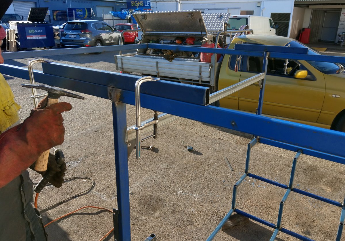

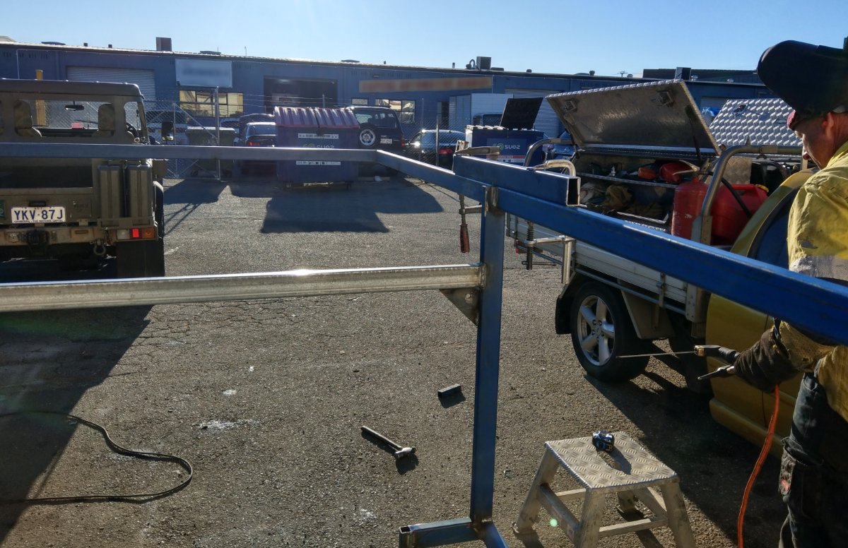

Pic from today - welding on the Luton end and gussets.
It was frosty at daybreak, -6 deg C, coolest May morning in a decade.

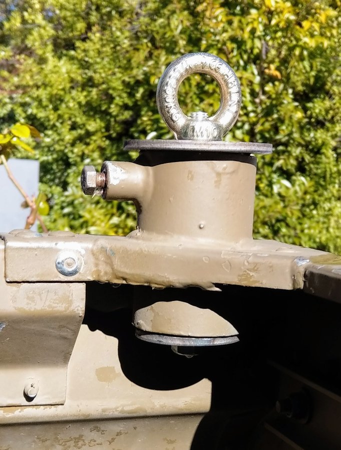

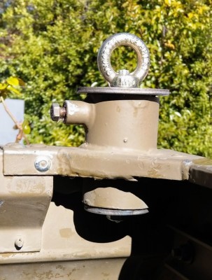

Welding - more work with gussets and trying out the franken flange. Ver 1.0 was soon rejected or rather superceded with ver 2.0 using some purpose built and exact fitting discs to minimise lateral movement.
Instead of trimming the oval galvanized flanges or welding a smaller diameter pipe piece to the faces of the discs, a smaller disc was welded in to match the rollover pipe socket sections we are using as mounts.
Tested on site. No movement...
