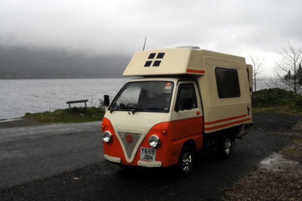

No not the same Romahome - ours was on a 1.3 Daihatsu Hijet. The worst thing about the Hijet are the headlights and yes the tail lights / sidelights run through the same fuse. But the worst in my opinion is that the headlights especially the driver's side are prone to rusting out. Now the version of the Hijet sold in Europe is not manufactured by Daihatsu but by an Italian scooter manufacturer Piaggio and in their wisdom they do not produce or sell replacement headlights for RHD.
My solution was a front end custom job that enhanced the resale value!
Jon

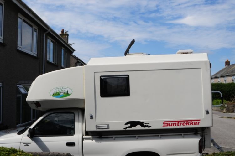

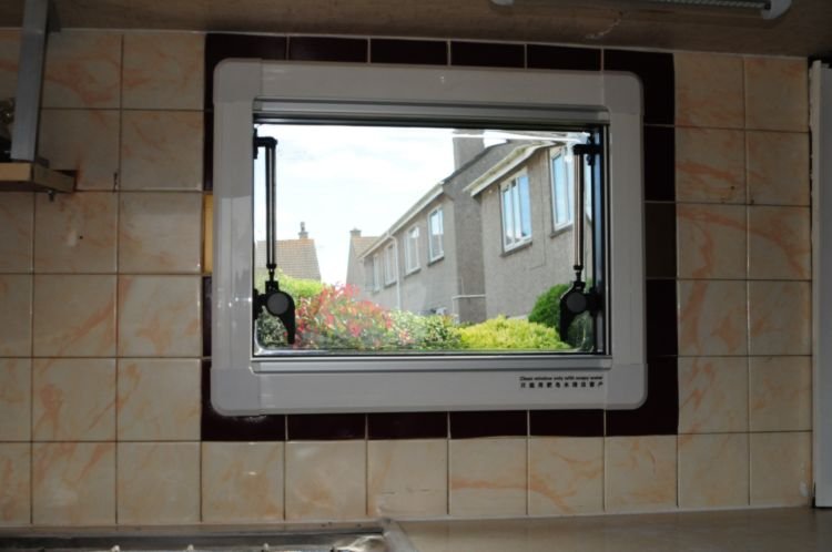

A bit of an update. After talking to Wonkywheel at Whitby and looking at his van I decided to fit a window in the blank wall. I purchased a Shield (Seitz copy) 750mm x 450mm Window. Shortened the kitchen shelf and this is the result.
download/file.php?mode=view&id=7061
I think it is the best compromise getting more light into the camper while not taking away too much of the kitchen area storage - one shelf has had to be reduced in size.
download/file.php?mode=view&id=7062

Surprising actually how adding a little more light can dramatically improve an interior plus it also breaks up an exterior and makes them less 'van' looking,

Looks good Jon.
