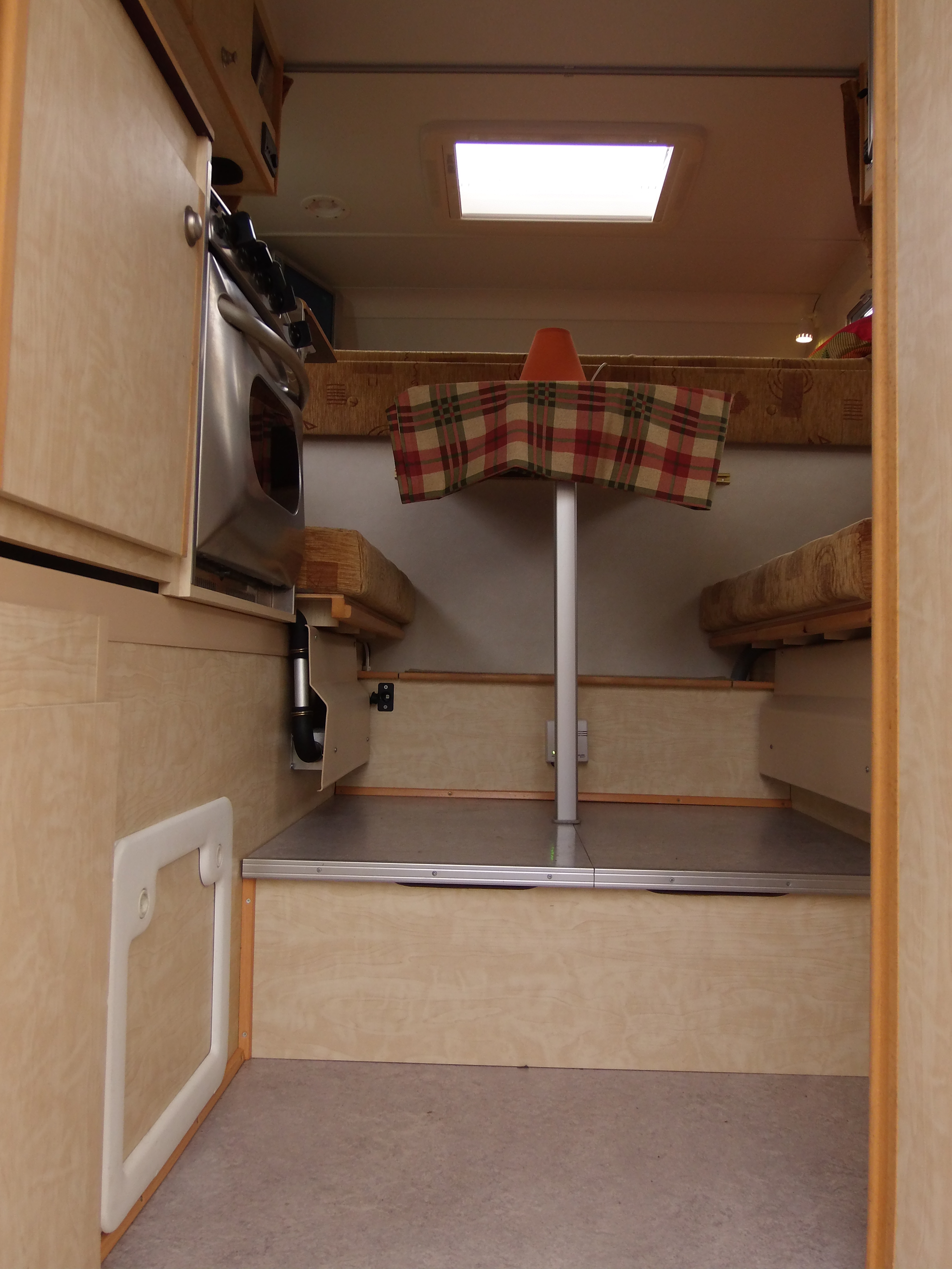

Cut the under table side panels
Fitted the cabin end vertical framework in position to confirm the step from false floor to seat and into the cab over bed was not too big ;)
I needed to check the comfort heights of the under table false floor storage area with regard to knee position eating height. The table is designed to move over the seat to enhance worktop area when cooking. With this in mind, I had measured the worktop heights of Richards camper. Within 5mm.....result ;) The still only near finished cushion completed the mock-up
With the crate acting as a section of false floor being 250mm it should be about the right height for the storage batteries.
There is little more to be done with the base section at the moment. It's always easier to work without the walls getting in the way but I will only screw the internal fittings in place. At least to start with because I want to be able to change the layout after a bit of trial (and error) use.
