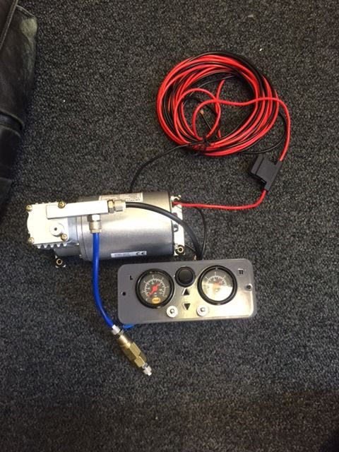

Compressor and control panel too

standard compressor, couple of gauges, a non-return valve (should have an arrow stamped on it to indicate flow) and prevents bags air leaking back into compressor chamber.
fused supply to comp and best only switched off ignition to prevent battery drain and waking neighbours :D

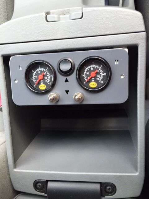

On that pannel, what do the controls actuall do please, can see the clocks of course so N/S & O/S bag i reckon

All fitted the compressor is fitted under the rear seat with the controls mounted in the centre arm rest.
There is a switch to pump up both bags and a pressure gauge for each. There is also a release valve for each bag.
All pumped up to see it it holds air.
