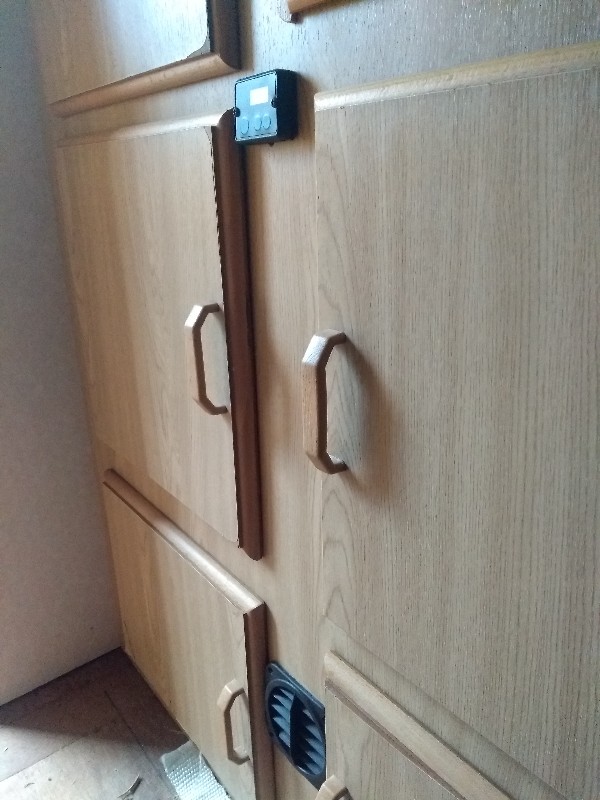

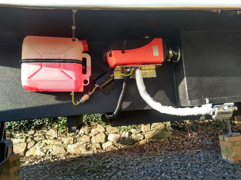

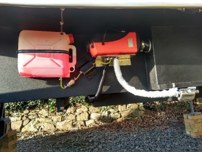

So finished installing a "Chinese Air Diesel Heater" "I'm using kerosene. On Start up it draws quite a bit to get the glow plug ready, but when running not a lot at all, the hose out the top of the tank is a siphon filling hose . So far so good , it's a 5kw and cost around 150£.
Great info from a FB group *Chinese Air Diesel Heater trouble shooting Group*
I'll update as I use it
