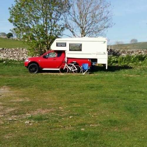

This is a De-mountable camper built for a single cab pick-up BUT it has been fitted to a King/Extra/Super cab.
Just because it will fit on the load bed of the pick up doesn't mean that it is correct, the center of gravity will be wrong with too much of the weight back over the rear axle.

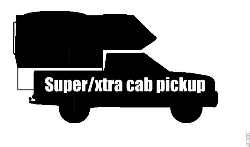

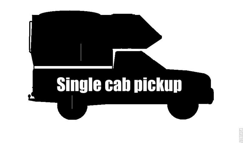

These by Steve might illustrate the centre of gravity moving by mis-matching camper & truck
