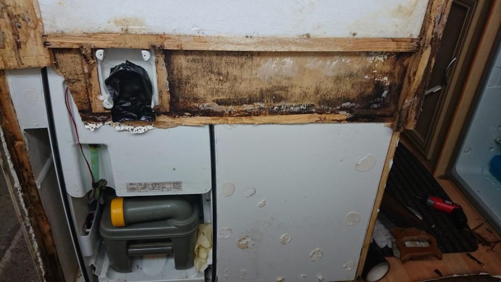

I think most of the soft wet wood is now cut out, so rest will just sand back and I will treat it .
Onwards !!

Ply cut to overall shape
[url]
Hole cut for the casette toilet, template used was the metal skin which I had to remove to get at the wood
Hole cut for door frame which was actually easier than I thought,
Next job is to take it all off again and seal with varnish.
Still have to get the ally skin sorted have found a localish caravan repair place which say they may have some offcuts I could use.

Bit further on today started the waterproofing of the ply one coat on has to dry 24hrs.
Made up a plate plus infill from the bottom floor which had rotted out (may be a 3 inch sq)to fix the bottom jack plate. As the jack plate is fixed length the thickness is critical. Might need a bit of the light touch with a hammer to get it all to fit.
Hmm the sealent look a bit messy must smarten that up
