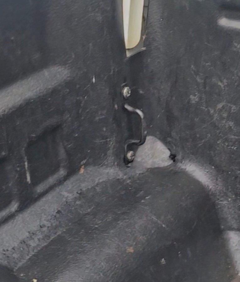

I am new to the group and I'm about to purchase a demountable for my Ford Ranger Supercab (1.5 cab not double cab). I was looking in the forum on how to attach it and this post came up from 2015 - so thought someone might be able to reply if I resurrected it!
Your comments about slop and inertia have been very useful and something I'll be looking out for and checking on regularly.
Now, the demountable I am buying has hatches inside that open up to reveal areas where it's own mounts are located and in this area will be some bolt-on mounts that are on the side of the flatbed - these are existing and part of the vehicle (factory fitted).
I was originally going to drill and bolt M10 eyelets into the flat bed base with 5mm steel plates below. Then attach the mounts on the demountable to the newly installed eyelets with ratchet straps. The existing owner has said he has used this set up and it has served him well for many years. He usually tightens the straps, goes for a drive around the block, then checks for tightness (or any slop).
However, since there are mounts already there on the sides of the flat bed (that weren't on the vehicle the original owner used for his set up), I thought it might be sensible and save time to use them.

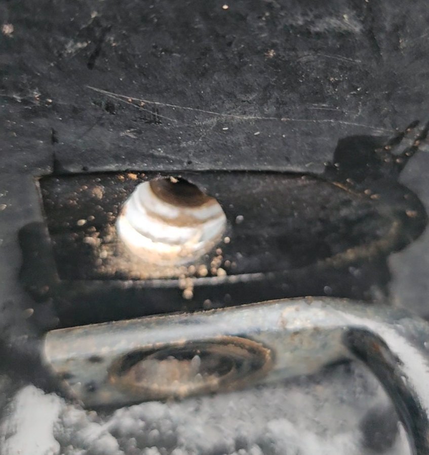

Please see the photos attached. There are six of these bolt-on mounts. One on each side at the front, two on each side at the back. All of which I believe are accessible through the hatches. Four ratchet straps could go on with the back two going through two mounts each.
Behind the bolt-on mounts it looks like a nut has been welded on - so a fair amount of thread to tighten up to.
Does anyone have experience doing this?
Help or advice on this matter would be greatly appreciated!
Thank you, Robert
Bolt-on mount
Bolt-on mount
Thread behind
Thread behind

Further to the above , I've just seen another post about anchor points.
It seems it can be a real issue so I shall go back to the original advice od the current owner - a good strong M10 eyebolt and a 150mm x 150mm plate below (5mm thick).
Sounds like from the other post that cornering can produce very strong pull on the sides. :shock:
Thank you, Robert

Post: # 40528Post zildjian
January 8th, 2026, 10:25 pm
Correct
Though that level of hard cornering is probably also likely to have the cutlery drawer and fridge empty all over the floor as well.
No, bolt 4x M10 eyebolts vertically up through floor and yes, with a spreader or BIG washer on underside.
Just be sure before drilling any holes that the camper floor section will pass between them.
I've for several years passed a ratchet strap down through slits in bed of truck, around chassis and back up to ratchets on camper corners, very accessible and never had an issue
