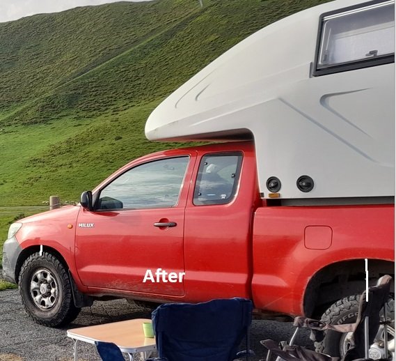

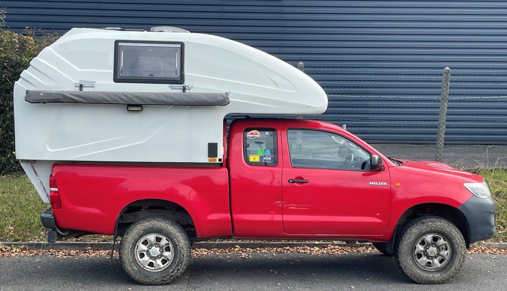

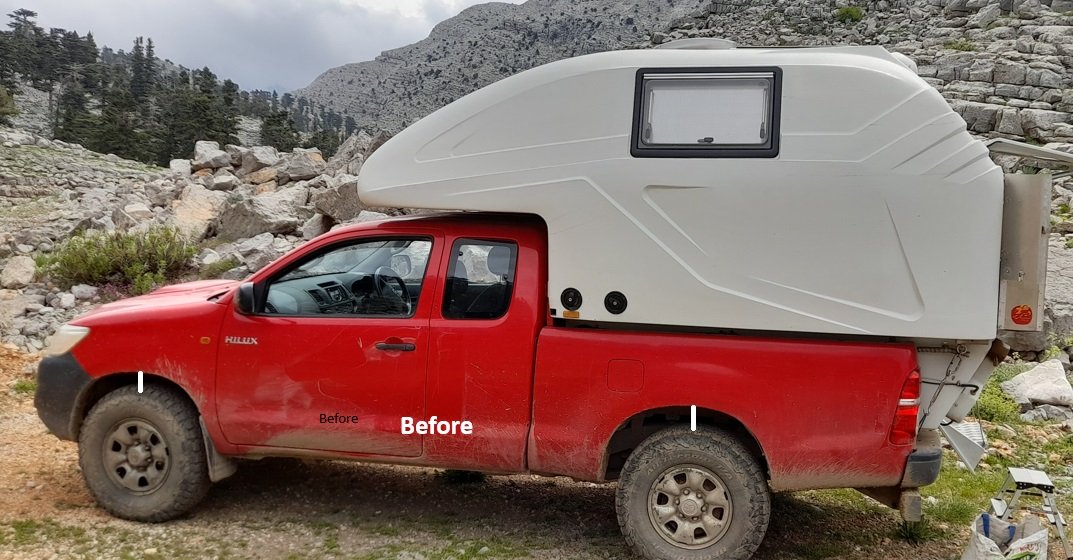

Hi, I have a Geocamper on a 2012 Hilux 2.5 extracab. I was doing alot of overlanding in it (Morocco/Pyrenees/Albania/Greece/Turkey) and have broken a few rear leaf springs in the process

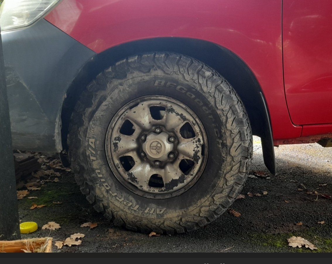

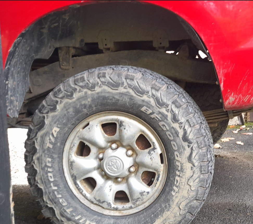

. I had it weighed once and I was at max weight so I upgraded to heavy duty leaf springs but this raised the back to the extent that it has damaged the front springs
. I now need to change out the front suspension.
So my question is: when I replace the front shocks/springs, should I upgrade the front too and bring it higher and in-line with the rear or should I bite the bullet and return to not-so-heavy duty rear leaf springs and a normal arrangement at the front?

Thanks Rob, I went for upgraded front shocks and that seems to have sorted it. I just need to see how it performs offroad now that it is sitting a couple of inches higher all round.
