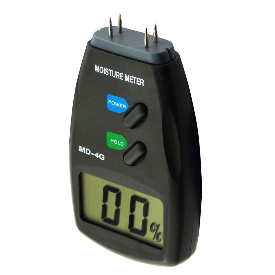

When buying any used camper we always recommend taking along a damp meter these are cheaply available from Ebay and simple to use and can save you a lot of money and act as a bargaining tool.
£8.79
Try everything electrical you can, ask about heating and water systems, and decide if its been lucky enough to enjoy winter storage out of the elements or has been damaged in the past
