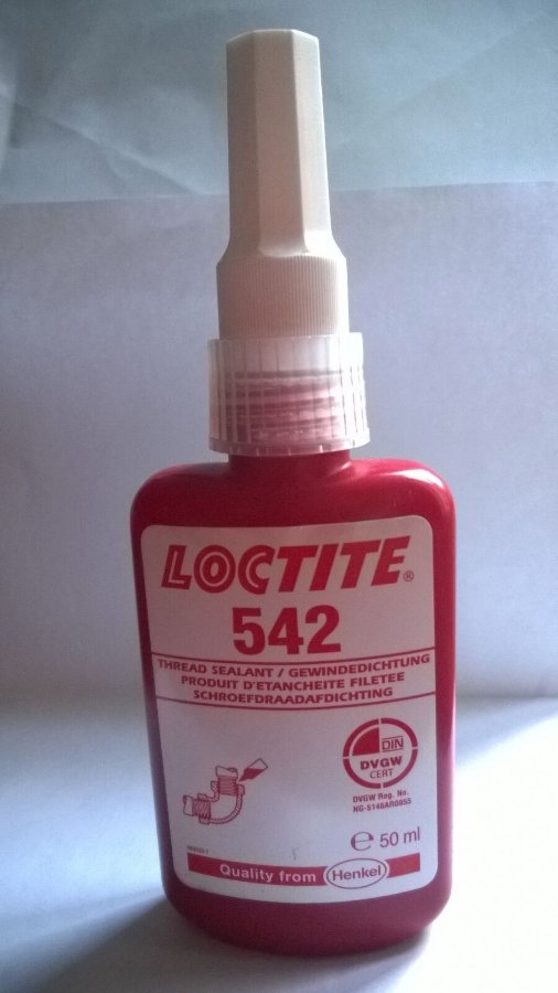

Mine at least has push fittings which means making the ends of each piece of pipe nice and square to prevent leakage but you might also want to use loctite thread sealant as well I always do and seldom lose air
