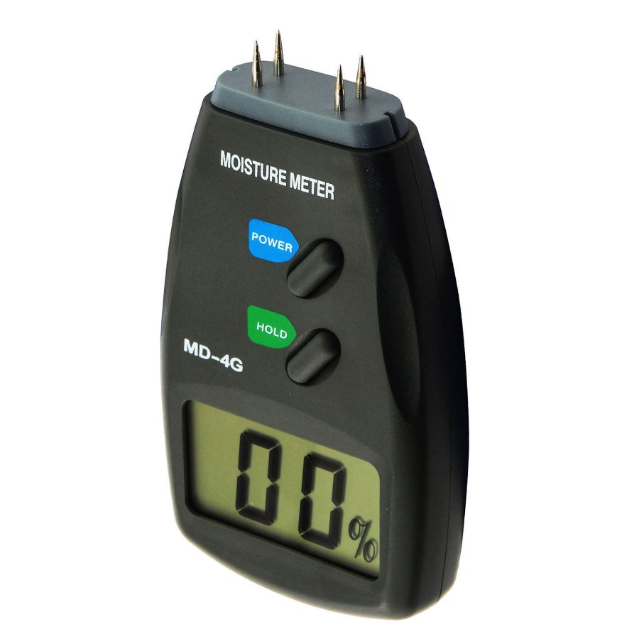

When buying any used camper we always recommend taking along a damp meter these are cheaply available from Ebay £8.79
and simple to use and can save you a lot of money and act as a bargaining tool.
