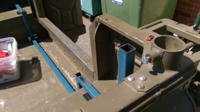

This beautiful Friday morning I drove the Landy 'sportscar' about 12km to the welder's yard to begin the frame work. It was a short time after sun up and really pleasant.
Today was a short session getting things underway, e.g.; the 9mm thick insertion rubber strip and orientation. I had a piece of foam board to do simulation but we didn't get that far along this week.
Framework - some floor pieces were cut to be tack welded. When the east-west subframe piece is checked and 'right' there will be 5 copies done. Afterwards I drove home in proper traffic
Next Friday some more welding. The main thing is the biv box is underway.

More framework yesterday. Totals 6.5hrs on the jobcard so far.
A few rethinks took time as you do on one-offs. Some mods on the 25x25 bits then tacked/checked the first east-west floor piece for fit, checked the insertion rubber and gaps. Now that we're okay on them there will be 4 more cloned off the first.
SIzed up and began cuts of the first 50x25 corner pieces. Again, a hands on practical mod was made to width - to better accommodate the 4 leg brackets and make sure the legs clear the vehicle sides.
