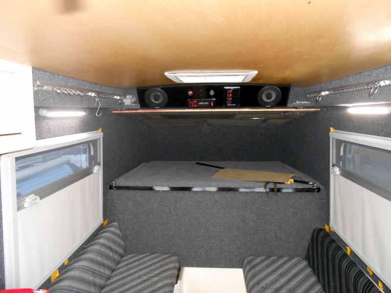

Postby Phoenixsp1 » June 5th, 2015, 9:48 pm
I completed a few jobs over the last week; The inside is now nearly fully re-carpeted with an extra layer of insulation underneath, i know it looks a bit grey and boring but at least it shouldn't show any dirt. I've fitted some blackout blinds at the windows with mozi nets which I prefer to the original curtains. The other job was fitting some led strip lights above the windows and I have one more to fit above the door. There is a birch ply panel which fits in the Luton roof which is missing on the photo as I have a bit of wiring to do behind the control panel so it wasn't worth putting back.
Plenty more jobs to do but I am getting down them slowly. If you're wondering what the yellow tape is for its not permanent, I was just marking some screw holes as its easy to lose them in the carpet.

Re: Suntrekker on T4 Double Cab project
Postby saDgit » June 6th, 2015, 8:02 am
Wow! That's looking really good Clive. Grey and boring is good - as you say, it hides the muck. As far as I can remember in our Suntrekker when we slid the bed out it came some way across the windows and would have fouled against those really nice blind/mozi net cassettes. I guess your hanging system avoids that huh?

Postby Phoenixsp1 » June 6th, 2015, 11:19 am
saDgit wrote:As far as I can remember in our Suntrekker when we slid the bed out it came some way across the windows and would have fouled against those really nice blind/mozi net cassettes. I guess your hanging system avoids that huh?
In theory yes but at the moment the clearance is a bit tight, only about 15mm each side, so you have to be pretty careful when you slide the bed out. This is not always the case if I've had a couple of beers. :o I cut the original steel support down by a couple of inches each end and bolted on the door strikers from a Passat as they looked nice stainless and were free. (You can see them in the pic at either end of the steel support) I think I'm going to cut the steel down the extra 2 inches either side so it's flush with the ply and then bolt the loops through the front of the steel support. I still need to have a method to lock the bed when it's slid out, I think I'll use a couple of door bolts that go into the side of the board, it needs to stop the board twisting otherwise the blinds would get damaged, hopefully it will work. :?: I still need to make some sort of headboard or trim the original one at some point.
