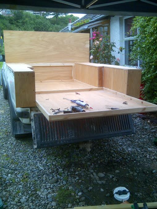

20.08.13
I started the build today. 12mm marine ply tub up to the level of the truck body, framed and braced with 22x44 and glued up with foaming polyurethane waterproof glue. I've chosen caravan steadies for the rear, which will be used to stabilise the rig when parked for sleeping. I ordered a couple of farm trailer steady jacks to lift the front end of the camper, I just have to fashion a strong fixing point for them. I don't expect to take the front legs away on trips since we wild camp one night at a time so we don't need to dismount the camper while we're away. I got a recycled caravan door complete with frame from a breakers yard, who also sold me an electric flushing loo and a zig unit for not much money. So I'm spending on a new waeco fridge and a couple of Seitz windows. I've ordered all LED interior and exterior lamps and a couple of roof ventilators. My Ebay has been very busy and I'll be seeing the Postie most every day for the next week or so. More later as I make progress with the build.

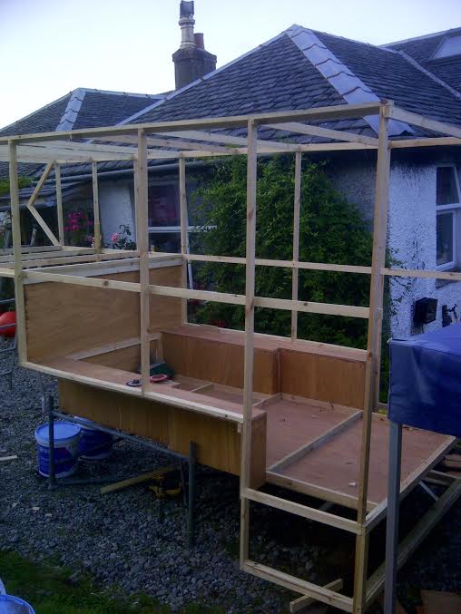

22.08.13
Well, the superstructure went up yesterday and today. Windows came, and I already have the door. I ran out of 44x20 today so I'll be getting more in the morning. Next phase is to make frames for all apertures and fix them into the structure. I changed my mind about the front profile of the luton. It was to have been a truncated triangle but after some head scratching I simplified it to a triangular point. Only two 45 degree cuts and a 90 degree corner. It will be easier to clad and to make weatherproof. Photos to follow if I can impose on zildjian to post them. Many thanks for that.

24.08.13
All the apertures have been framed out and test fitted today. The Seitz windows are brilliant and the caravan door was very easy to fit. I cut out the section of floor at the back to allow for an internal stairway. The plan is to create another two step stair which will stow upside-down in the stair well..I'm about ready to start putting on the outside skin. Pictures soon.

25.08
Got quite alot done today. I cut an aperture in the floor and fitted a stairwell, then beefed up the rear frames to take the full weight on the caravan corner steadies. They were a little too long so I used a big diamond wheel to trim them back.
Triple reinforced the front jacking points and test fitted the spigot for the front jacks. Front jacks are off to a friendly welder to be extended by 20 inches in the morning.
Trial fit of the windows and then jigged everything level in preparation for fitting the skin tomorrow.
Don't sound like much, but it took all day.
